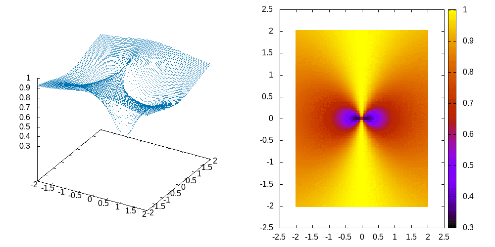

My main concerne with the interpolations is that some of them are'nd differentiable at R=0 due to the symmetry of some of my fields. For further insight on this you can look at the symmetric interpolation of the gamma_xx component in the 2D case in the attachement.I don't want to alter the actual PDE solver of my code, because doing a special routine for the interior of the black hole won't be very useful for the next step of my master thesis. In the next step I will port the code onto the GPU. Doing a special routine once at the beginning for ma static fields is no problem, but any kind of branching within the PDE solver is very bad for parallel optimisation.
