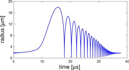

I have been trying to numerically solve the Rayleigh-Plesset equation for a sonoluminescing bubble in Python. You can read about this phenomenon here: https://iopscience.iop.org/article/10.1088/0143-0807/34/3/679.
The Rayleigh Plesset equation is a non-linear ODE, which can be solved to find the Radius of a bubble subject to non-linear oscillations due to an external driving sound wave (Sonoluminescence). Here is the form of the equation I used:\begin{equation}\ddot{R} = \frac{1}{R\rho}\Big(P_g-P_0-P(t)-4\mu\frac{\dot{R}}{R}-\frac{2\sigma}{R}+\big(\frac{2\sigma}{R_0}+P_0-P_g\big)\big(\frac{\dot{R}}{R}\big)^{3\kappa}\Big)-\frac{3\dot{R}^2}{2R}\end{equation}
I rewrote this as a system of differential equations (so that ODEINT would process it):
\begin{cases}
\dot{R}=u\\
\dot{u} = \frac{1}{R\rho}\Big(P_g-P_0-P(t)-4\mu\frac{u}{R}-\frac{2\sigma}{R}+\big(\frac{2\sigma}{R_0}+P_0\big)\big(\frac{u}{R}\big)^{3\kappa}\Big)-\frac{3u^2}{2R}
\end{cases}

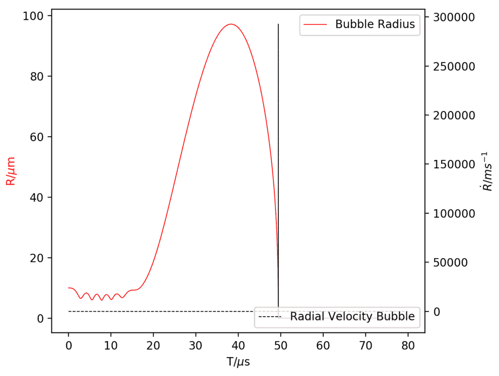

Here is the python code I have written. It plots both the radius of the bubble and its radial velocity.

The results from this code however doesn't coincide with literature. Indeed, my code only gives the first collapse, whereas it should show various non-linear oscillations. Not only, the velocity plot shows that the bubble expands at supersonic speeds (which also doesn't coincide with literature given the present parameters).
Here is what the output should look like:
Here is what the code gives:

Check your work again, you have lost a ## P_g ## between equation (1) and its restatement as a first order system, although you seem to have found it again in the code. However you have an R_0 where it looks like you should have a u.
Once you have got this right I expect the plot should take similar values to the original plot up to just before what appears to be a singular point at t ≈ 17.5μs, but I don't think you should be surprised if it doesn't get any further. You probably need to transform your system into something better behaved. You might also have more success with scipy.integrate.solve_ivp which is replacing the deprecated scipy.integrate.odeint.
Equation 1 and your python code don't agree.
Equation 1
Your python code with difference noted in bold red:
(P_g-P_0-70000*np.sin(2*np.pi*31700*t)-2*sigma/R-4*miu*u/R+(2*sigma/R_0+P_0-P_g)*(R_0/R)**(3*k))/(R*rho)-3*u**2/(2*R)
It seems to me that your python code should have ##\frac u R##, not ##\frac {R_0} R##.
Also, but not relevant to the problem you're seeing, There's a difference between Equation 1 (above) and what you wrote following "I rewrote this as a system of differential equations ..."
\dot{u} = \frac{1}{R\rho}\Big(P_g-P_0-P(t)-4\mu\frac{u}{R}-\frac{2\sigma}{R}+\big(\frac{2\sigma}{R_0}+P_0\big)\big(\frac{u}{R}\big)^{3\kappa}\Big)-\frac{3u^2}{2R}##
Equation 1 has ##(\frac{2\sigma}{R_0} - P_0 - P_g)##, but the equation just above is missing the ##-P_g## term.
o_O
Turns out the ODE i wrote in the code was the correct one, and that the one i wrote in latex is incorrect...
I might try out scipy.integrate.solve_ivp
