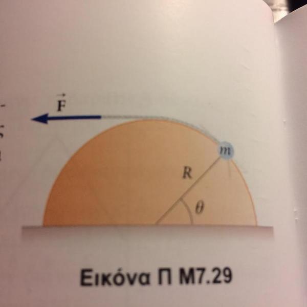

A small object with mass m is dragged without friction to the highest point of a semicircle with a radius of R, by a weightless rope.
a) If the magnitude of his velocity is constant, then his acceleration that is parallel to the semicircle, is zero. Prove that F = mgcosθ
b) Integrate the following swiftly W = ∫ F*dr, to calculate the work that is produced when the object is moved from the highest point, to the lowest.

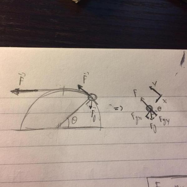

(a) So, first up I set the direction of the force F as the Y axis, and then created the net force (I don't know the proper term yet, but you get the gist of it from the pic). Like this:
Thus: ΣFy = mat = 0 <=> F = Fgy = Fgcosθ = mgcosθ

You shouldn't convert to Cartesian coordinates. It is easiest to answer both questions in terms of theta. That integral solution you found is exactly what you need. Now you just need the initial and final theta.

I know how the basic version works (only one kind of variable, say, x), and I have some experience with more complex types, but I don't know how to connect the angle (theta) and the displacement (r). The best I've got is:
W = ∫Fdr = ∫HighestLowestmgcosθdy = ∫900mgcosθRdθ = mgR∫900(sinθ)'dθ = mgR[sinθ]900 = mgR(sin90 -sin0) = mgR
I'm not sure if that's correct though.

That all looks fine, but it is a little confusing to use r and y as variable names with such non-standard meanings. You could use ds as a generic displacement along a path, and write ds=Rdθ.

Yes, that's it. And better with Haruspex's suggested labeling.
