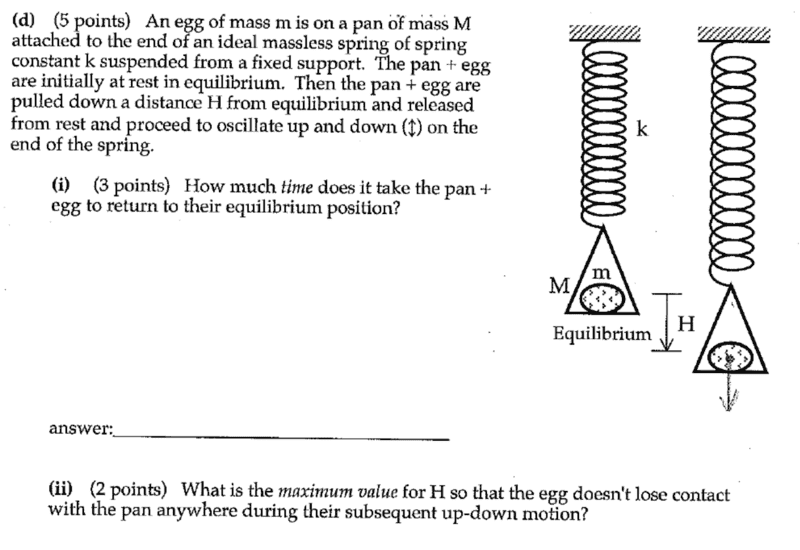

Object within a Pan Spring Motion
In summary, the conversation discusses the solution to a problem involving spring motion equations and an egg on a pan. The solution involves finding the time it takes for the egg to return to equilibrium, which is half a period, and identifying the forces acting on the egg to determine its maximum acceleration. The maximum acceleration is determined by the egg's position at maximum amplitude and the forces acting on it.

Part a is straightforward I believe.
Simply combine the masses as m+M, into ##\omega = \sqrt{\frac{k}{m+M}}##
So then ##T = \frac{1}{f} = \frac{2 \pi}{\sqrt{\frac{k}{m+M}}}##
I believe the time it takes to return equilibrium should half a period, so we get ##\frac{\pi}{\sqrt{\frac{k}{m+M}}}##
Part b is the tricky part, I'm not sure how one goes about it. I guess the first step would be identifying all the forces on the egg
The egg has an upwards normal force from the pan, along with a downwards force from gravity.
It would experience a force from the spring when it is being pulled up or down.
I imagine you would try to find the sum of forces and find when it is not in equilibrium?
Think that through again.
Consider accelerations. During SHM, where in the cycle is the maximum acceleration? What determines the maximum acceleration of the egg?
Yeah definitely half a period, since you pass by the equilibrium point after half a period. Since spring motion is sinusoidal, it'll start from rest, into maximum amplitude, then passes by the equilibrium point, into the compressed form, back out into the equilibrium point in one period.
Acceleration is greatest at the maximum amplitudes, so either when it's fully stretched or compressed.
##a = -(2 \pi f)^2 x##
Right, and the question is asking for the time from one extreme to equilibrium.
Yes. But is there anything in the set-up that limits the acceleration to which the egg can be subjected?
