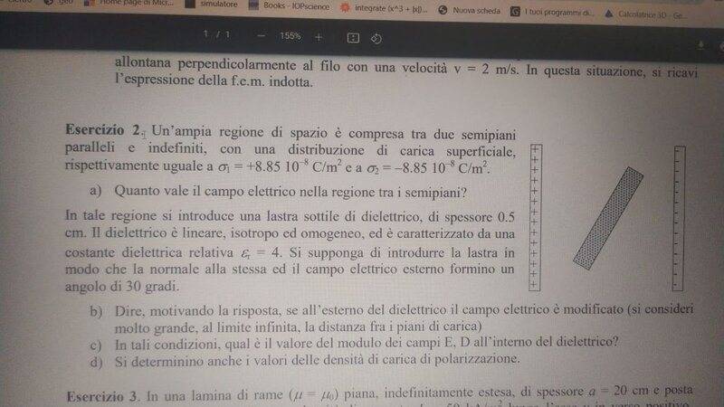

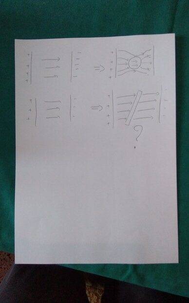

With reference to picture, l have an oblique slab of material dieletric in a capacitor. The plates of capacitor are infinite and far. How can calculate E and D in dieletric?

Please, show us your attempt.
Hint: Do you know about boundary conditions for E and D?
Also, please provide a complete statement of the problem in English. Thanks.

first of all sorry for my bad english.
there is a uniform electric field E created by two plates with superficial charge +/- ## \sigma## .
the plates are infinite and far.
you put inside a dielectric material .
Now i am doubtful.
if the outside field is modified l don't know how to use boundary condition,otherwise l do.
But why shouldn' t outside electric field been modified by the slab of dielectric?this seems the way to solve this problem, that is field no modified.
To modify the external field, the charge on the plates must be modified. You are told that the plates are very far away. So assume that the external field is not modified by the presence of the dielectric slab and proceed.
the charge on the plates aren't modified, but ##E_{total}## =##E_{capacitor}##+##E_{dielectric}## is modified, so that you don't know the direction of ##E_{total}## to apply boundary conditions

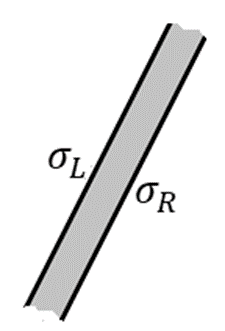

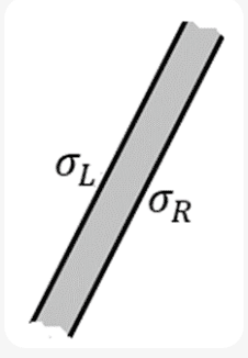

It might be helpful to first deduce some important properties of the induced surface charge density of the dielectric slab based on the simple geometry of this system. I think you can neglect "edge effects" of the dielectric slab. In other words, treat the dielectric slab as infinite in size (except for the finite thickness). Let ##\sigma_L## and ##\sigma_R## be the induced surface charge densities on the left and right surfaces of the slab, respectively.
What are the signs of ##\sigma_L## and ##\sigma_R##? How do their magnitudes compare?
Can you treat ##\sigma_L## and ##\sigma_R## as uniformly distributed? If so, what is their net contribution to the total electric field outside the dielectric slab?

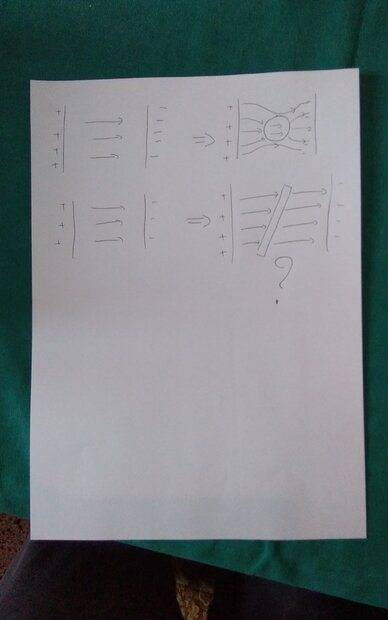

why with a uniform dieletric spere field changes and with slab no?

Have you thought about my questions in post #8?
To help decide if ##\sigma_L## and ##\sigma_R## are uniformly distributed, consider @kuruman 's suggestion that the system is invariant under translation of the slab. In particular, consider translations of the slab that are parallel to the large surfaces of the slab.
Because Laplace's equation in the case of the sphere depends on two variables, ##r## and ##\theta## while in the slab it depends only on ##x##.
Thinking about @TSny's questions in post #8 is another way if you are not sure about the symmetry argument.

what breaks the symmetry in the case of the sphere, I feel like exactly the same symmetry argument as of post #15 can be used for a sphere too ...
Only thing I can think off right now is that the normal to the surface of this slab is a constant vector, but the normal to the surface of a sphere is not constant, it depends on ##\theta,\phi##.

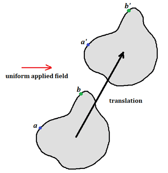

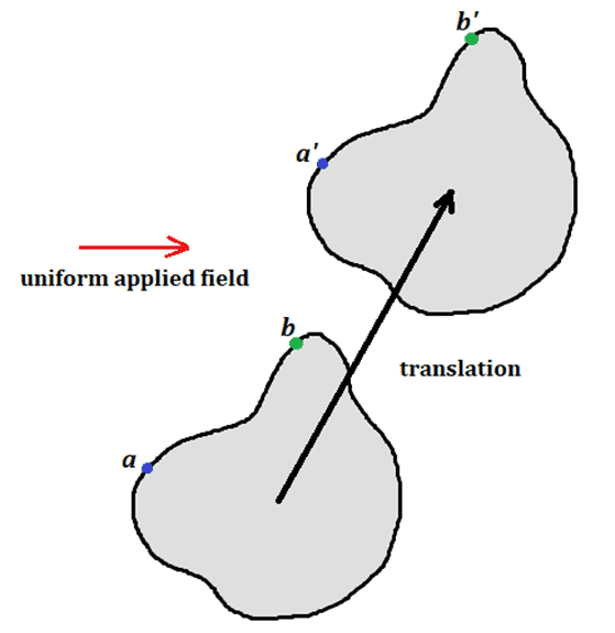

There are two symmetries involved here regarding the surface charge density of the slab.
The first is a symmetry that is associated with the fact that the externally applied field is uniform. For any shaped dielectric placed in the field, a translation of the dielectric will not change the charge distribution on the dielectric.
So, if point ##a## gets translated to point ##a'## and ##b## to ##b'##', we can conclude that ##\sigma_a = \sigma_a'## and ##\sigma_b = \sigma_b'##. But we can't conclude anything from this symmetry about how ##\sigma_a## compares to ##\sigma_b##.
The second symmetry that we can use is that for the slab, a translation of the slab parallel to itself carries the slab into itself. Imagine the slab is placed in an arbitrary applied field that is not necessarily uniform, such as the dipole field of two fixed charges ##q## and ##-q##.
Let the translation take point ##a## to point ##b##. So ##a \rightarrow a'= b## while ##b \rightarrow b'## (not shown). Point ##a'## after the translation is in the same "physical condition" as point ##b## was before the translation. So, ##\sigma_a' = \sigma_b##. But this symmetry doesn't tell us anything about how ##\sigma_a## compares to ##\sigma_b##.
For the case of the slab being in a uniform applied field, we can use both of these symmetries to deduce that ##\sigma_a = \sigma_a' = \sigma_b##. So, ##\sigma_a = \sigma_b##. For any two points ##a## and ##b## on the left face of the slab, we can construct such a translation. So, any two points on the left face have the same charge density.
Likes stefano77 and Delta2

That's right. For two points ##a## and ##b## on the surface of the sphere you can have a translation that takes ##a \rightarrow a' = b##. But, even if the applied field is uniform, we cannot say that the "physical condition" of point ##a'## after the translation is the same as the physical condition of point ##b## before the translation. The "physical condition" at a point on the spherical surface includes the value of the applied field at that point as well as the relation of that point to all of the other points of the sphere. For example, as you noted post #19, the orientations of the normals at ##a'## and ##b## are different.
