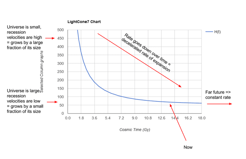

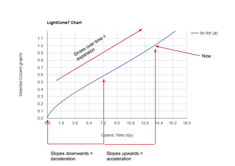

The rate of expansion in kimbyd's post is another name for the Hubble parameter ##H(t)## - it tells you by what fraction all distances grow at a given time.
For example, its value at the current epoch ##H_0## (aka Hubble constant) netts approximately 1/144 % of growth per million years (which is just another way of writing the more familiar ~68 km/s/Mpc).
The Hubble parameter has always been and will continue to decrease, in the far future asymptotically approaching some fixed value determined by dark energy.
What used to be decelerating and has since started to accelerate is the growth of the scale factor ##a##. The scale factor tells you how large all distances are compared to those same distances at some other time. It's like the nett growth, as opposed to ##H## being instantaneous percentage rate.
A good analogy to visualise the difference is a savings account in a bank. The scale factor is how much money you have. The Hubble parameter is the monthly interest rate.
If the interest rate does not change between months, the amount of savings will grow exponentially. If the rate goes down eventually reaching zero, the amount of savings will eventually stop growing. If the interest rate goes down but to some positive value*, the savings may at first grow by less every month, but eventually will start growing exponentially (i.e. there will be a change from decelerated to accelerated growth).
*Example of such a rate: 1+1/n %/month, where n is the number of months the money's been sitting on the account = the rate approaches 1 % as time passes.

I'm not sure I understand this. Is the rate of expansion of the universe slowing down or speeding up, or do we know?
The expansion is accelerating.
But the rate of expansion is slowing down.

I'm not sure what would that mean, but it's likely a matter of using different names for the same thing.
Here's the standard usage:
##a(t)## - scale factor, 'size of the universe' as compared to today (not the observable universe - the distance between any two arbitrarily chosen points in the universe, e.g. some two galaxies)
##\dot a > 0## - size of the universe is getting bigger over time, 'expansion of the universe'
##\dot a < 0## - size of the universe is getting smaller over time, 'contraction of the universe'
##\frac{\dot a}{a} = H## - Hubble parameter, 'rate of expansion' = by what fraction of its size does the universe grow per unit time
##\dot H > 0## - rate of expansion is increasing over time, 'accelerated rate of expansion'
##\dot H < 0## - rate of expansion is decreasing over time, 'decelerated rate of expansion'
##\ddot a > 0## - growth of the universe is speeding up over time, 'accelerated expansion'
##\ddot a < 0## - growth of the universe is slowing down over time, 'decelerated expansion'
Can you tell me where have I lost you with the interest rate analogy? Can you see how you can gain more money in interest (expansion accelerating) even though the interest (expansion) rate is going down?

The rate of expansion is defined as recession velocity over distance. An object that is twice as far away as another object will be receding at about twice the speed.
If the rate of expansion is a constant, then as an object gets further away, its recession velocity will increase.
This is why I prefer to use the term "accelerated expansion", rather than to say the expansion is accelerating. In a universe with an accelerated expansion, objects within the universe are getting further away from one another at an accelerated rate. The rate of expansion (recession velocity per unit distance) will still be either decreasing or constant (there are good reasons to believe it can't increase).
