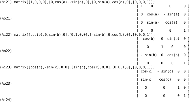

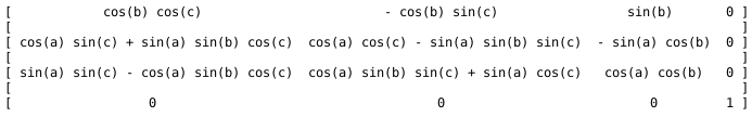

I made a mistake for what wanted to state that R is (because I assumed that theta_x = theta_y = theta_z, by accident). I attached R.png and RxRyRz.png to show my corrections. a = theta_x, b = theta_y, c = theta_z

That's a good question! The answer sheet to the midterm assumes we can figure out R from the hint:
Let ##R## be the rotation that maps the plane normal (3,2,1) to the z-axis. Such a matrix was given lecture 2, page 4...
We need to look at lecture 2 page 4. I think an answer in the form of symbolic angles ##a,b,c## wouldn't be given full credit. The values of ##a,b,c## should be expressed as functions of the numbers given in the problem. The order of multiplying rotation matrices does matter.

The numerical matrix given in the answer sheet is the final result of ##R^T M R##. You don't need the "p^".
where R = RxRyRz
I'd have to see the lecture notes to know what form the rotation matrix is supposed to take. Another forum member may know.
