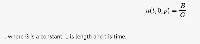

I have a PDE which is the following:
$$\frac {\partial n}{\partial t} = -G\cdot\frac {\partial n}{\partial L}$$
with boundary condition: $$n(t,0,p) = \frac {B}{G}$$
, where G is a constant, L is length and t is time.
G and B depend on a set of parameters, something like $$B = k_1\cdot C^a$$ and $$G = k_2\cdot C^b$$, where C is a given variable.
I am using finite differences method to integrate this PDE, but I also wanted to obtain the derivatives of n with respect to its parameters (k1, k2, a and b in this case) along the integration. How can this be done?

In the first PE it appears that $n$ is a function of at least two variables t and L.
In the boundary condition n(t,0,p) they are now three variables. The vatiable p is new. We don't know what variable is equal to 0.
Then, a new "given variable" appears C with no connection to the PDE or with the preceeding variables.

## \frac {\partial n(t,L,p)}{\partial t} = -G(p)\cdot\frac {\partial n(t,L,p)}{\partial L} ##
General solution : ## \quad n(t,L,p)=F\left(\left(L-G(p)\:t\;\right)\:,\:p\right)##
where ## F ## is any differentiable function of two variables.
The goal now is to find which function(s) ##F## complies the boundary condition ## n(t,0,p)=\frac{B(p)}{G(p)} ##
If such a function exists, then :
## F\left(\left(-G(p)\:t\:\right)\:,\:p\right)= \frac{B(p)}{G(p)}##
The term on the left side is function of ## t ## , while the term of right side is not. This is a contradiction.
So, at first sight, there is no solution of the PDE which agrees with the boundary condition.
This draw to think that something is wrong or missing in the first part of the wording of the question.

Frist you wrote that ##G## is constant :
Now, If ##G## is fonction of ##t## , the general solution of the PDE, before any further conditions is :
## n(t,L,p)=F \left( \left( -\int G(t)dt \right)\:,\: p\: \right) ##
where ##F## is any differentiable function of two variables.
But it is not possible to continue if the wording of the question always changes.
Best regards.
First you wrote that ##G## is constant :
Now, if ##G## is function of ##t## the general solution of the PDE , before any further condition, becomes:
## n(t,L,p)=F\left( \left( L - \int G(p,t)dt \right)\:,\: p\: \right) ##
Well, it is not acceptable to continue with successive changes in the wording of the problem.
Best regards.
