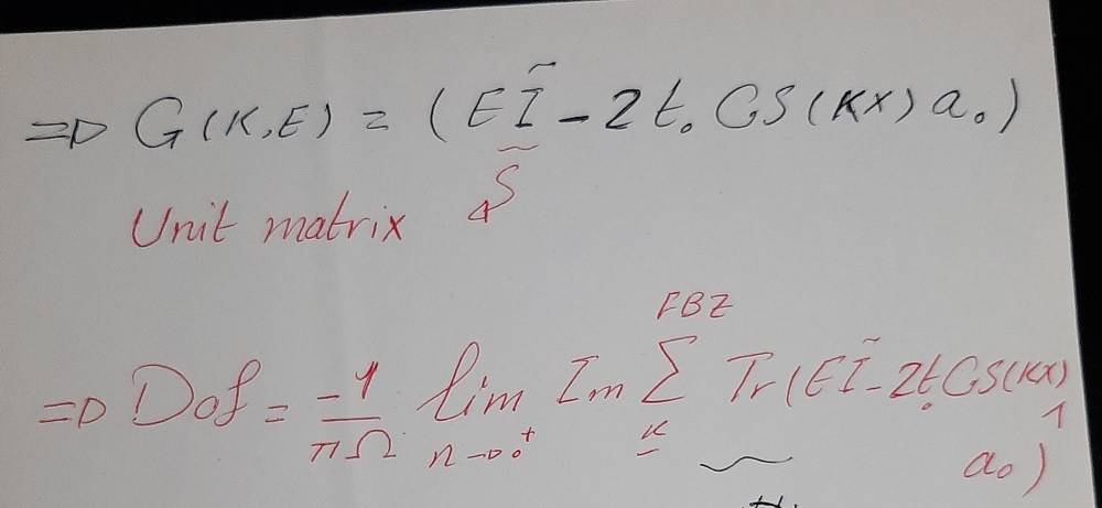

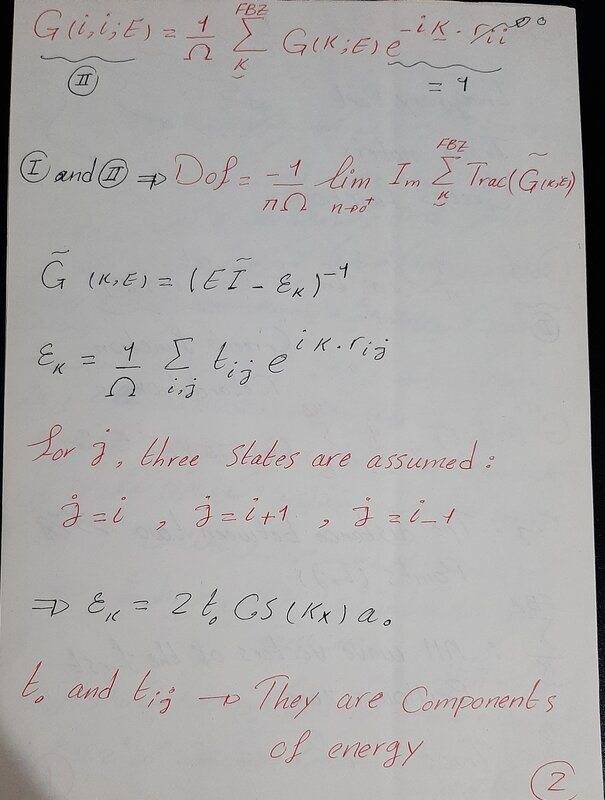

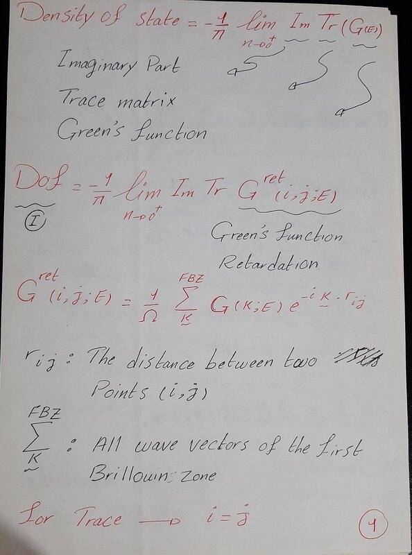

My purpose in introducing the X and Y variables is to separate the real and imaginary parts of the energy component.If you pay attention to the coding, after the two loops, (energy and ek), the relation related to the Green function is given, which consists of the difference between the data obtained from the energy loop and the ek loop.
Of course, the question for me is whether the Green function relation is mathematically correct or not? Because as I said, this relationship is the difference between complex data (energy) and real data (ek).
The Green function is a function of the wave vector, and because of the effect (Tr) on the Green function, we see the sum operation on all values (k). The Green function is inside the loop of k.
