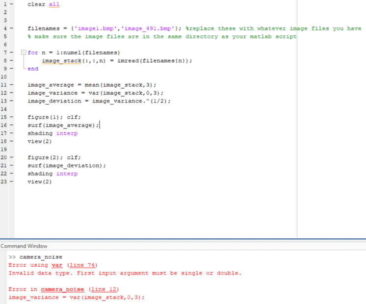

How can I subtract the camera noise from my real image? Basically, I want to calculate the center of gravity of a diffracted spot without the influence of my camera noise. I will be glad to know how this can be done.

Thanks for your response. Is there a software in which I can just import the images and calculate the average as well as the std. Or I need to write a code? normally, I am not really good in coding. and I am newly learning how to use matlab. If it requires some code, I will be glad if an example can be sent to me. Thanks.
Matlab Image Averaging:
filenames = {'image1.png','image2.png'}; %replace these with whatever image files you have
% make sure the image files are in the same directory as your MATLAB script
for n = 1:numel(filenames)
    image_stack(:,:,n) = imread(filenames{n});
end
image_average = mean(image_stack,3);
image_variance = var(image_stack,0,3);
image_deviation = image_variance.^(1/2);
figure(1); clf;
surf(image_average);
shading interp
view(2)
figure(2); clf;
surf(image_deviation);
shading interp
view(2)
That should do it. I can't test it for you because my personal PC is allergic to MATLAB since R2020a. Sorry
Likes PhysicoRaj
Thanks for your response. Kindly find attached the error that occured.
Just replace line 5 with
image_stack(:,:,n) = double(imread(filenames{n}));
Thanks a lot twigg. I really appreciate.
