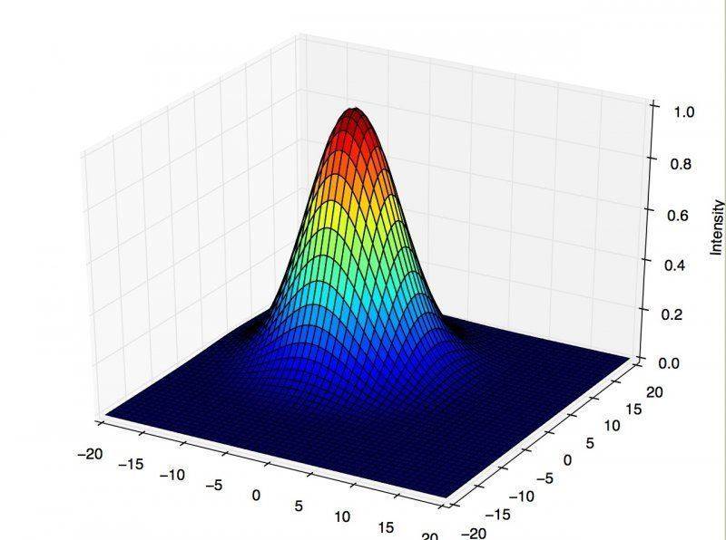

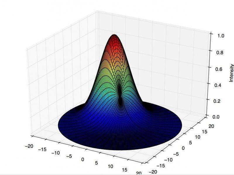

When I run this code, it works. But due to the random number generator, sometimes the input values have the graph centred near the origin (e.g. set r0 = 5), and when this occurs, there seems to be an odd indentation in the graph itself. Maybe I'm missing something, but if I'm trying to display a 2D Gaussian, this shouldn't be there, right? If anyone has any thoughts on why this is occurring and any ideas to approach this problem, that would be greatly appreciated!
Technology news on Phys.org
I don't understand what you mean.
If you set r0 first and THEN determine r and p around it...would that center it as you desired? or would that defeat the purpose of what you are trying to do?
It's an artifact of your mesh. I've modified your code a bit so I can choose between a polar mesh or a cartesian mesh, and so I can optionally specify the centroid and variance:

I get the following plot when I run this via python plot.py --centroid -5 5:
Using a polar mesh (python plot.py --centroid -5 5 --polar) yields the following:

I get the following plot when I run this via python plot.py --centroid -5 5:View attachment 83929Using a polar mesh (python plot.py --centroid -5 5 --polar) yields the following:
Thank you so much for the help!
