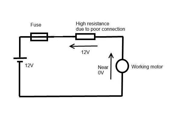

OK so the symptoms are..
"Input wires, not connected to pump: 12v"
"Input wires connected to pump: 0v"
Pump works when connected to known good supply.
In my post #11 this is the circuit I had in mind that could explain these symptoms.
You might be measuring 0V at the motor because 12V is being dropped across a loose connection that has high resistance but is not totally open circuit. When you measure without the motor present you get 12V because as I said the connection isn't totally open circuit.
The loose/poor connection could be in the +ve supply or in the ground/return. Ground/return faults are quite common on vehicles.
oh right i got it now , sure if you have a loose connection somewhere it's basically like the load isn't attached at all , electrically so measuring at the load side will return no voltage.
I was just under the impression that you are speaking of a situation where there is a high resistance load attached and all electrical connections are ok and then you get no voltage which would seem odd.
