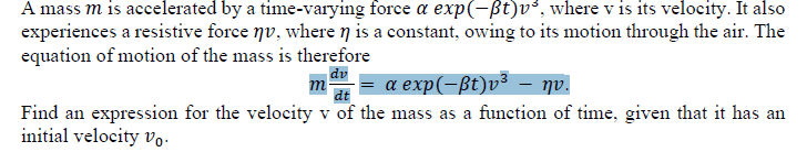

A mass ๐‘š is accelerated by a time-varying force ๐›ผ ๐‘’๐‘ฅ๐‘(โˆ’๐›ฝ๐‘ก)๐‘ฃ3, where v is its velocity. It also experiences a resistive force ๐œ‚๐‘ฃ, where ๐œ‚ is a constant, owing to its motion through the air. The equation of motion of the mass is therefore
๐‘š๐‘‘๐‘ฃ/๐‘‘๐‘ก= ๐›ผ ๐‘’๐‘ฅ๐‘(โˆ’๐›ฝ๐‘ก)๐‘ฃ^3 โˆ’ ๐œ‚๐‘ฃ.
Find an expression for the velocity v of the mass as a function of time, given that it has an initial velocity ๐‘ฃ0
