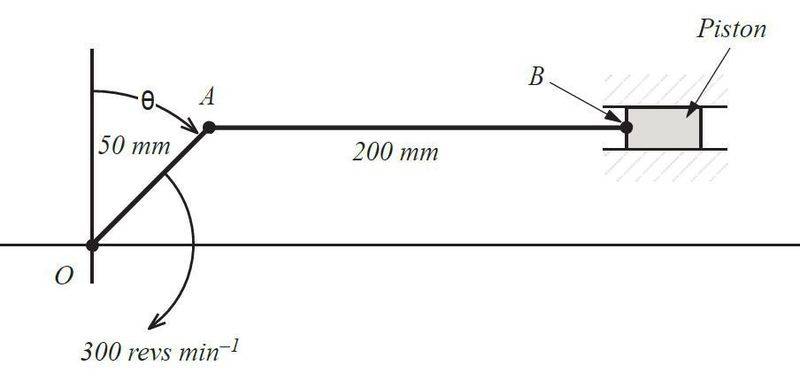

A) Determine the value of the angle θ (measured from vertical) when the angular velocity of link AB a maximum.
B) What is the maximum angular velocity of link AB.
This is a part of a bigger question. I've managed to answer all other part apart of those two. Can anyone point me in the right direction. I'm not an expert in this subject. Just let me know if you require any more data.

1) For the mechanism shown in the figure included within the #1 post determine for the angle θ=45°:
a) the velocity of the piston relative to the fixed point O (VBO)
b) the angular velocity of AB about point A (i.e. ωAB)
c) the acceleration of point B relative to A (αBA)
Note: Link AB is horizontal when θ=45°.
2) Determine the value of the angle θ (measured from vertical) when:
a) the velocity of point B=0
b) the angular velocity of link AB a maximum
3) What is the maximum angular velocity of link AB?
ANSWER:
ωOA=300 revsmin-1=10π rads-1
lOA=0.05m
lAB=0.2m

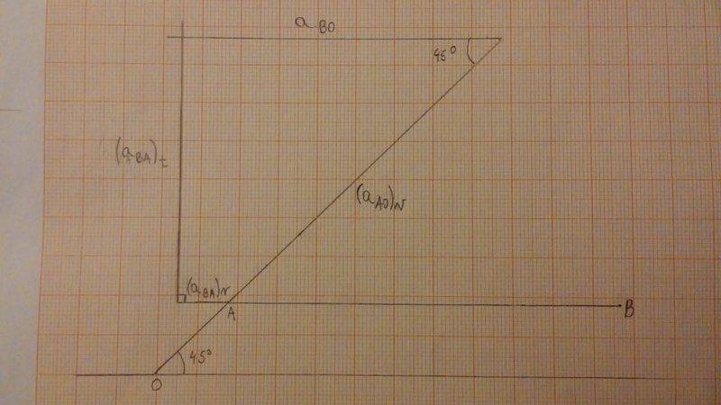

c)
αBA(r)=lABAB2=0.2*5.55352=6.1683 ms-2
ωOA=VAO/lOA=1.5708/0.05=31.416 rads-1
αAO(r)=lOAOA2=0.05*31.4162=49.3482 ms-2

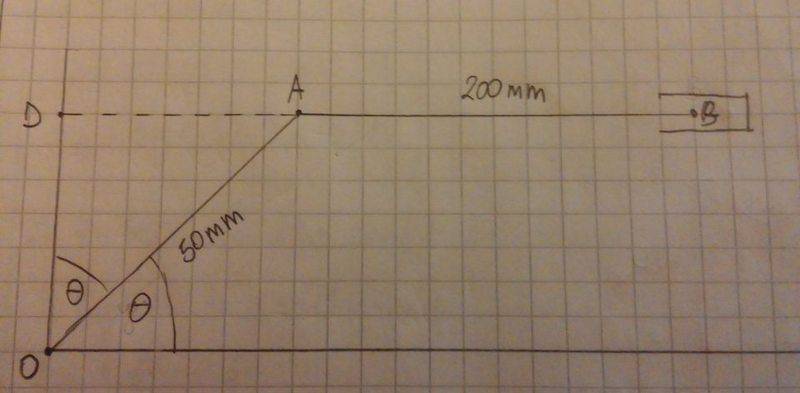

drawing acceleration diagram using following scale (see acceleration diagram attachment)
1 cm=20 mm
1 cm=5 ms-2
measured from the graph
αBA(t)=6.9cm=34.5 ms-2
2)
a)
The velocity of point B=0 occurs at maximum and minimum piston displacement.
calculating the offset height lOD (see the graph attachment)
cosθ=lOD/lOA
lOD=cos45°*lOA=(√2/2)*50=35.3553 mm
calculating at max displacement.
lOB=lOA+lAB=50+200=250 mm
let the angle symmetry line through O and the crank-connection rod at max piston displacement be γ
sinγ=lOD/lOB=35.3553/250=0.1414
γ=arcsin(0.1414)=8.1289°
so θ at max piston displacement (measured from vertical) is θ=90°=8.1289°=81.8711°
calculating at min displacement.
let the angle symmetry line through O and the crank-connection rod at min piston displacement be β
sinβ=lOD/(lAB-lOA)=35.3553/150=0.2357
β=arcsin(0.2357)=13.6329°
so θ at min piston displacement (measured from vertical) is θ=270°-13.6329°=256.3671°

One thing I noticed on drawing for this problem, the angle that OA makes with the horizontal is not θ. It's (π/2) - θ , i.e. 90° - θ. It's only equal to θ for θ = 45° .
