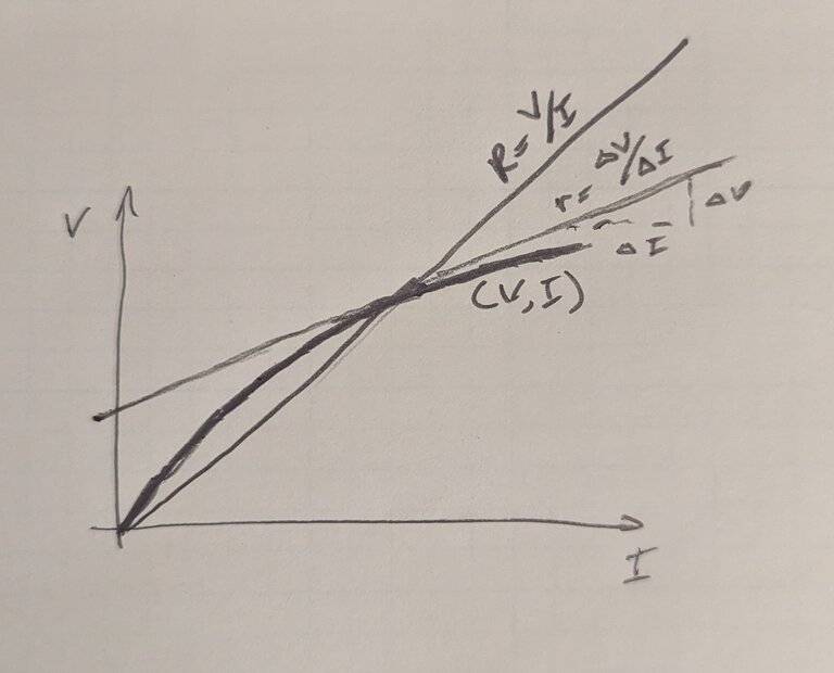

Um... no, not really. You can use the local resistance ##r = \frac {\Delta v}{\Delta i} ## for calculations near the (V,I) DC operating point. This is distinct from Ohm's Law which is global ## R = \frac{V}{I} ##. Because the dominant factor in the resistance change is thermal, for fast events you can use the global resistance ## R ##, but this opens a can of worms about how fast is fast, since ## R ## is changed as it heats/cools. It is a resistor, but it's value changes with temperature (thus operating point).
(Pretend two of those are straight lines, also that (V, I) is really (I, V), LOL)
Sorry that explanation kind of sucks, but I have to go.
