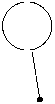

Consider the wire as shown below. The rotating shaft is not shown. Draw the line of action of mg and see if that helps determine the location of O. Then you can add the rotating shaft to the drawing.

Directly above m, inside the hoop, but can i do that? Will the rotating shaft and hoop-wire come in that position? I thought that they would remain in the same positions relative to each other.

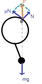

If you have drawn the diagram correctly (now), the frictional force and the normal force should balance the weight of the mass. Do you have the mass vertically below the point of contact?
Here it is. Now i find mg = N(μ2 + 1)1/2 .

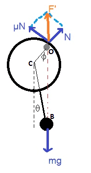

OK. Try to find θ by working with the geometry of triangle OCB shown below. Point C is at the center of the circular portion of the wire.

That's much closer, but you seem to have drawn the rod from the mass meeting the ring at its lowest point. It needs to point at the centre of the ring. Compare with TSny's diagram.

Thank you! By the law of the sines I have that $$ sin \theta = \frac {sin \phi R}{l +R} $$
Then ## \mu N = mg sin \phi = N \sqrt {\mu ^2 + 1} sin \phi ##
And by substitution ## sin \theta = \frac {R \mu}{(l +R) \sqrt {\mu ^2 +1}} ## that si the correct result!
