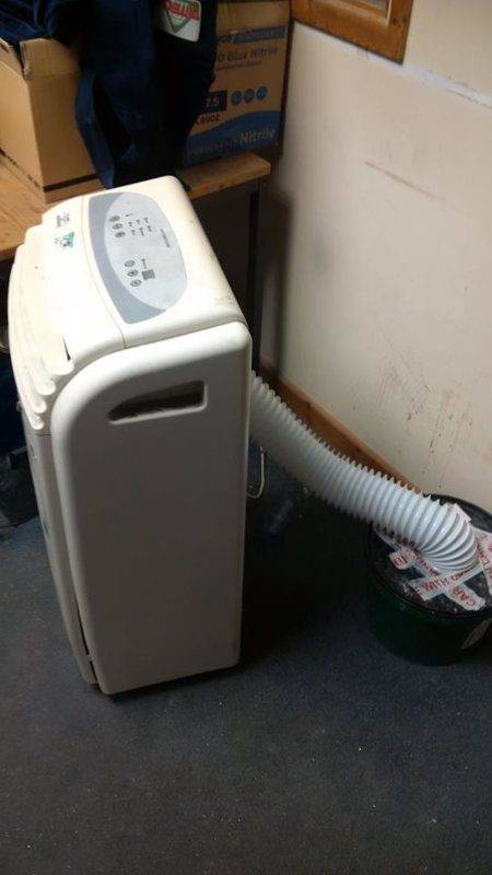

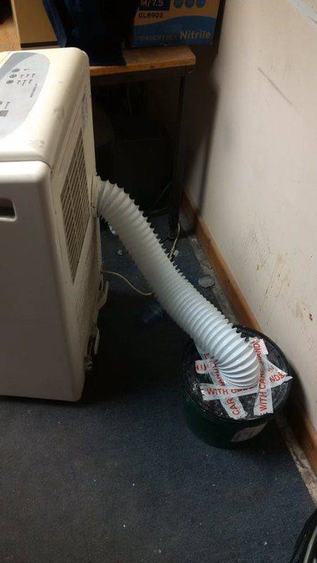

You could always try what one genius at my work decided last year. I guess you simply empty the bucket outside once it's full of heat XD
Likes 256bits and russ_watters
I see a problem with that.
It's not failsafe.
If he inadvertently leaves the unit on all weekend, and the bucket overflows, Monday morning people will come in and there could be 'heat' all over the floor. What a mess.
:H
