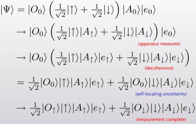

I see there are various attempts in the literature to address this. For example, Sean Carroll's has written about "self-locating uncertainty"[0]. My problem with it looks to be in essence the one given here[1]. Namely, their argument rests on the supposed distinguishability of two ways of writing the very same state:
$$|O\rangle \otimes (|A\rangle + |B\rangle)$$
$$(|O\rangle \otimes |A\rangle) + (|O\rangle\otimes|B\rangle)$$
They claim that because we can write it the latter way, the observer should consider himself "branched" even before he encounters the system in question. This seems to be having one's caking and eating it too: because I haven't branched I avoid the problem of "which me is the real me?" but because I have "mathematically branched" I am allowed to introduce a concept of probability.
Sebens and Carroll’s self-locating uncertainty seems to be meant to be an uncertainty about an objective fact about reality: either I am the observer on the up branch or the observer on the down branch, but I’m not sure which. But then how can these be possible facts about reality, when the choice of branches is agreed to be not objective, but rather an arbitrary mathematical choice which – remember – can be made in many generally incompatible ways in generic models?
I feel myself being pulled into a rabbit hole, so maybe best I put this on pause :).
I don't think this is correct. The state of the observer has to be entangled with the state of the observed system in order for "branching" to occur. So, schematically, the process would look something like this:
\vert O \rangle \otimes \left( \vert A \rangle + \vert B \rangle \right) \rightarrow \left( \vert O_A \rangle \otimes \vert A \rangle \right) + \left( \vert O_B \rangle \otimes \vert B \rangle \right)
where ##O## without a subscript indicates that the observer has not yet observed the ##A / B## system; ##O_A## indicates that the observer has observed result ##A##; and ##O_B## indicates that the observer has observed result ##B##.
In other words, making an observation changes the observer's state. If you don't include that in your analysis you won't get the right answers.

Yes, this is precisely my problem with it. Have a look at the paper or the associated blog post. Here's an image:
Sean Carroll said:
The point is that in between steps ["decoherence" and "measurement complete"], the wave function of the universe has branched into two, but the observer doesn’t yet know which branch they are on. There are two copies of the observer that are in identical states, even though they’re part of different “worlds.” That’s the moment of self-locating uncertainty.
"Measurement complete" is the point of entanglement with the observer, i.e. his point of actual branching. The "self-locating uncertainty" step is just a rewriting step (distributing the tensor product), but they claim it has decision-theoretic consequences. It seems to be a sleight of hand: branching before really branching. I don't see how this is reasonable, and if it weren't for the paper I cited, I would end up assuming I simply misunderstood:
As Carroll takes pains to point out, the main question here isn't how to get the specifics of the Born rule, but how to interpret the meaning of "probability." If you try to do it after the split ("measurement complete"), you face the meaninglessness of "I could have been another me," and so you are forced to find a meaning before the split / entanglement.
The point of actual branching is the decoherence step; that's when it physically happens. Self-locating uncertainty can happen well after that and in fact does, until you have gathered enough information (and broadcast it into the environment) to determine which version you have become.

I recommend reading the paper. "Self-locating uncertainty" refers very specifically to a point before one "wakes up as A or B." It is the key innovation of the paper. What you call "waking up" is there called "measurement complete," and at that point there is no uncertainty (with respect to the branches in consideration) by definition.
Notice I said his actual point of branching, i.e., the point at which he becomes entangled with the system. Clearly the environment has branched during decoherence.
Please look again at his image I shared, and his accompanying description.

Here's an image
The decoherence step looks misplaced. If the observer is going to get entangled with the observed system (and environment), that has to happen before decoherence. But I haven't read through the papers you linked to in detail; I'll try to when I get a chance.
The image matches the description in the paper / blog. He's just saying that the particle and apparatus encounter many unaccounted-for degrees of freedom before the observer interacts.
Sean Carroll said:
Think of observing the spin of a particle, as in our example above. The steps are:
  1. Everything is in its starting state, before the measurement.
  2. The apparatus interacts with the system to be observed and becomes entangled. (“Pre-measurement.”)
  3. The apparatus becomes entangled with the environment, branching the wave function. (“Decoherence.”)
  4. The observer reads off the result of the measurement from the apparatus.
If that's the case, then there are really two "measurements", not one, in the scheme being described. The first is when the apparatus becomes entangled with the environment, which decoheres the measurement made by the apparatus on the system. The second is when the observer becomes entangled with whatever he becomes entangled with in the course of reading off the result of the measurement--which doesn't seem to be described in any detail at all. As I said, I haven't read the papers in detail, but if we are looking for a place where a lot of handwaving is occurring, this would seem to be a good place to look.
