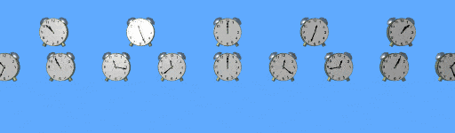

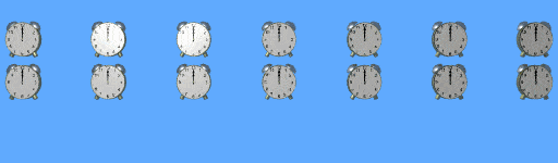

I set up a visual aid for this concept a while back, that used more than just two clocks in each frame.
Imagine two rows of clocks passing each other with some relative velocity. All the clocks in the lower row have been synchronized to each other according to the rest frame of the lower row.
We have also arranged its so that the clocks in the upper row are spaced apart and tick at a rate such that as measured from the frame of the bottom row, they are in sync with the lower row. Any time a lower and upper row pass each other, they read the same:
(here we just show that duration between the clocks reading 12:00 and 2:00)
Now we view things from the rest frame of the upper row.
Now, in the above animation, the upper row is in relative motion, so the lower row is measuring a length contracted distance between the upper row of clocks, and is also measuring a time dilation of the upper clocks.
In its own rest frame, the upper row measures the distance between it clocks as being the proper length (further apart than as measured by the lower row) and It's clocks ticking at a non time dilated rate.
At the same time, it measures the distance between the clocks in the lower row as being length contracted, and the clocks ticking at a time dilated rate.
In order to maintain the fact that when lower and upper clocks pass each other they read the same, the clocks in neither row can be in sync as measured from the upper row rest frame, and you get this according to the upper row:
No clock in either row reads the same as another clock in its own row, but every time a lower and upper clock pass each other, they read the same.

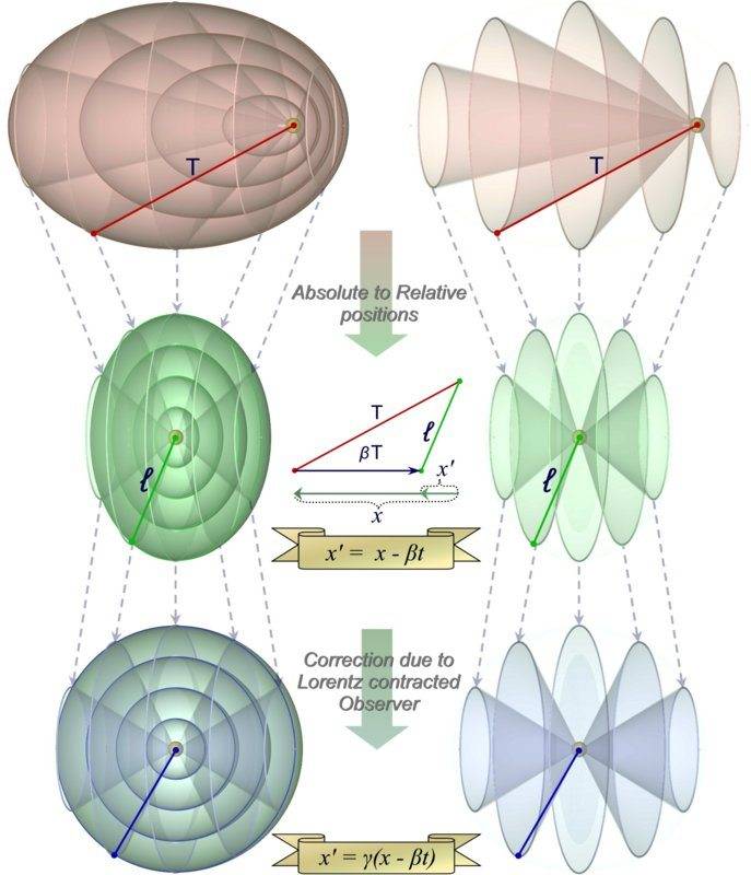

The image below serves to illustrate the following from my original post:
Hans de Vries said:
Question 6: But why do reference frames change if we are moving?
Answer 6: After we accelerate things in front of us look bigger while things behind us look smaller.
Question 7: So the viewing angle changes? Does this completely define the transformed coordinate system?
Answer 7: Yes, from the different viewing angles we assume different distances and time.
Question 8: Okay. but why, and how, do the viewing angles change?
Answer 8: First simple vector addition: Draw a light-ray hitting you from an angle, add your velocity and you have a new angle. Then take into account that you are Lorentz contracted to obtain the angle as you observe it.
The image shows the 2 steps of the last paragraph:
1) Vector addition: Draw a light-ray hitting you from an angle, add your velocity and you have a new angle.
2) Then take into account that you are Lorentz contracted to obtain the angle as you observe it.
So,
If we define that, in a rest-frame, the propagation is the same in all directions, then we have spheres of simultaneity around the observer. What the observer sees at a certain moment is a build up of information from many different distances. The bigger the distance, the further it is back in time (with time defined as in the rest-frame)
For an observer moving to the left we get the ellipsoids of simultaneity instead. (top-left of the image). The observer is in the focal point of the ellipsoids. events on the surface of an ellipsoid are simultaneous in time according to the definition of time for the moving observer.
The information reaches the moving observer at a certain angle with speed c while the observer moves to the left at speed v.
The middle part of the image shows step 1) The vector addition: The sum of the two vectors gives a new angle. This is the angle under which the information arrives at the moving observer in the moving observers rest-frame.
The bottom part of the image shows step 2) The angles as seen by the Lorentz compressed observer. The flattened spheres in the middle images are corrected by a factor ##\gamma## and now become the spheres of simultaneity as seen by the moving observer in his rest-frame.
Therefore c is constant in all directions again in the reference-frame of the moving observer. PS: the image is from my book here
