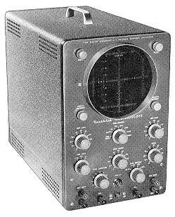

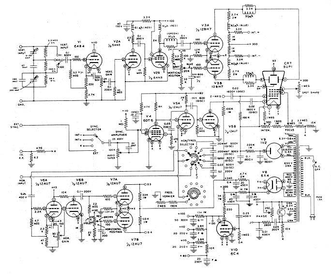

That's for a crt tv isn't it?
Yes, but do you know what all those round components are...? :biggrin:
Actually, I believe that it's an 0-scope.
Oopsies, good point. Guess I should do more than just skim... :-p
There's a few different round ones on there which one do you mean?
Yes it's an Oscilloscope kit by Heathkit. I still have the one that I made and used years ago.
If I had posted a Television schematic with those round components, it would have covered the screen. That would have been infraction worthy. o:)
