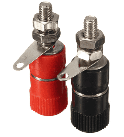

I'm thinking of a terminal like the ones below when the nuts are not tight.

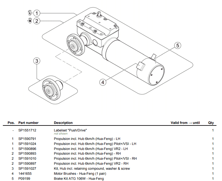

That's the picture I get from for a wheelchair.
It is a whole assembly.
( To post a picture, for windows, right click on the picture, copy all of the address from the popup, at PF at the top of the posting click on the picture icon ( right next to the smiley face ) , paste the address in the box Image URL , and then click INSERT. )
That's the left side. Right side is similar.
from
https://www.mobilitysmart.cc/invaca...-gearbox-electromagnetic-brake-left-side.html
https://www.mobilitysmart.cc/parts-spares-c-106/power-chair-parts.html
the cylinder part is the DC motor.
The rectangular part is the gearbox.
The sliver disk looking part attaches to the wheel directly with bolts most likely. Call that the hub.
From the hub to the gearbox is a shaft that can be called the axle.
It seems that a clutch and brake are integral to the assembly. And those might be acting up also.
They also have pictures of motor brushes, so I would naturally assume that those can be replaced if need be.
It doesn't hurt to look that whole part over if you can.

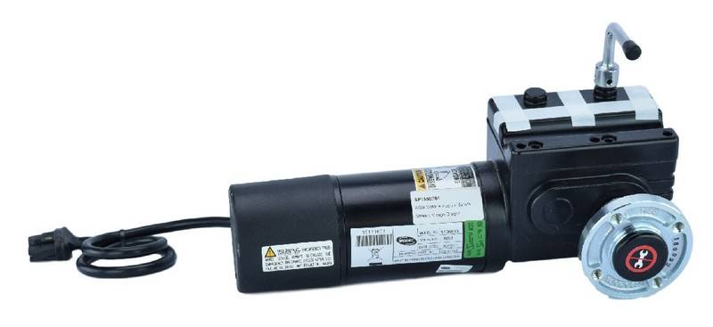

Here'a another thing you can do to test. Buy or borrow a non-contact temperature gun. You can get one for less than £8.
If a bearing or lubrication is the problem, the bearing will be warmer than the body of the motor. If the problem is electrical or due to excessive load, the body of the motor will be warmer than the bearings. If the gearbox, or the clutch is the trouble, then it will be the hottest point.

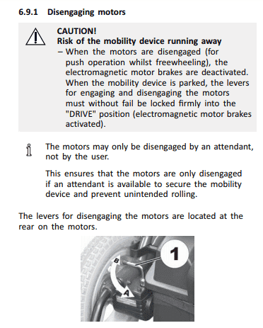

Wheelchairs have brakes, often directly mounted on the back end of the motor shaft. They are typically multiple discs, similar to a multiple disc clutch or the Coaster Brake on old single speed bicycles. They are applied by default and released when the motor is energized. It sounds like the brake did not fully release on that one motor. Perhaps due to dirt in it or a loose electrical connection. The other possibility is that motor has an intermittent short in it... but I would go with a stuck brake first, especially with your description "...started to judder and slow down and pull to the right."
Wheelchairs generally have a manual brake release, sometimes called "freewheeling lever" or similiar, so the chair can be pushed if the drive fails. That would be a possible workaround the next time the situation arises. Depending on your tool inventory and mechanical adeptness, you can likely at least get access to the brake assembly for inspection. SInce the brake defaults to 'engaged' via a rather stiff spring, don't disassemble further than you can reassemble! It may just need a cleaning and debris removal.
Oh, and the chair stopping in that situation is normal, the motors have a thermal overload in them for their self-protection.

Hi Tom, thanks for replying. I think you have solved my mystery. I thought the oil had done the job because it was the only thing that I changed between running hot and running warm BUT until you mentioned it I had forgotten the brakes, as you know Wed was extremely hot and where the chair stopped was in full sun, so I released the brakes manually to scoot backwards into the shade and then re-engaged the brakes to wait for it to cool down. If it was debris or dirt in the mechanism, manually operating them may well have dislodged any blockage. As for the thermal cutouts, these have come into play in the past but only on very hot days going up the steep hill near my home, on those occasions both motors stopped and I just waited for them to cool, press the reset buttons and away we go. On those occasions there was no juddering or slowing down, just running normally then stopping dead as you would expect, also the motor was nowhere near as hot then as it was this time but the cutout did not operate, so I think that it was the friction of binding brakes causing the heat. I will try to check the electrical connections and clean the brakes out this morning. Thank you again for your help.

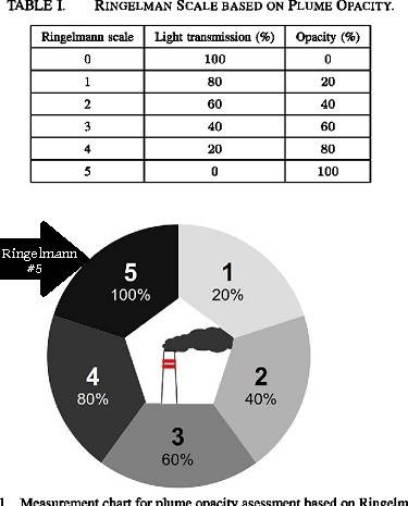

No internet back then . It took me years to figure out the Ringelmann #5 cigar pun - Ringelmann is an opacity test for smokestacks..

Roysmokie said:
...I expressed my theory (wrong as it turned out) and probably pointed responders in the wrong direction...
To give responders a starting point, you expressed a tentative conclusion based on the circumstances, the materials available, the observed results, and past experience. That's all any of us can do. In fact, in the Homework threads this is required.
I had a suspicion about the brakes but the photo that @256bits posted, showing the extended rear cover on the motor, was the clincher.
It just happened that I had worked with motors that had built-in brakes before; specifically about 50 years ago when developing controls for an anti-aircraft gun!
As @anorlunda said, Kudos to everyone. And thanks for "The Sherlock Holmes Award" too. (Now if I can just find a frame for it... :wink:)

Kindly refer this to your most gray haired engineer . Send a copy to your Quality folks, too
My Invacare Mirage recently stranded me as described in the attached letter.
You have a flawed design in that the brake can apply itself unannounced. I got stranded in an unsavory location and feared for my safety..
You need to incorporate a manual mechanical brake override for use when the circuit to the brake solenoid fails open applying the brake. .
You should also send a corporate troubleshooter to the service department to find the reason behind the pathetic response i received to my inquiry.
Here's all the detail of the brake assembly i could find in your parts catalog.
Kindly send me a replacement brake unit. I will use it to replace my failed one and send it to you. Surely your quality folks will want to figure out what failed.
I'll also add a lever and cam to accomplish manual brake override and send a photo for your engineers ..
Likes sophiecentaur, dlgoff and Tom.G
Invacare service manual and parts catalog - find your exact model ?http://www.invacare.co.uk/sites/uk/files/product_documents/fd17eeac3b23549bb92035e6b4c8910fda3649bc_558bb3d29301cc5c6a8b9c74.pdfhttp://www.invacare.co.uk/sites/uk/files/product_documents/a60e2c71cd2d8f0a3e89fe1514da8daa163acd19_MIRAGE_invacare_EN_2016_11_29_19_11_58.pdf
