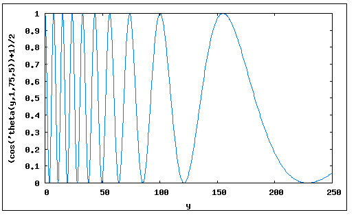

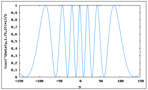

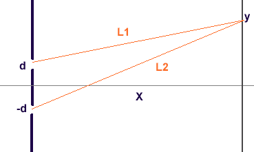

The single photon experiment of Grangier showed that if a phase shift ##\theta## is introduced in one arm of a Mach-Zehnder interferometer then there is interference when the two beams are recombined - even if only one photon is introduced.
If a particle encounters a double slit of suitable geometry then one possibility becomes two which are recombined at some point on the screen. I wondered what the result would be if the phase difference in the MZ could be expressed in terms of the two slit geometry. This is easily done and the result is ##\theta_s=2\pi(L_1-L_2)/\lambda## where ##L_1^2=X^2+(y-d)^2,\ L_2^2=X^2+(y-2d)^2##.
One of the detectors in the MZ setup has probability ##(1+\cos(\theta))/2 =\cos(\theta/2)^2##. Putting ##\theta_s## into this looks like this for X=75, λ=1, d=5
which at least looks plausible. I'm not sure if this is interesting or valid, but it is all quantum.

I think you'll find the L2 formula should just be ..+d.., not ...-2d... But yes, the Young's slit pattern shows the same stretching off-centre as your plot. We often use a simple formula for calculating the spacing of interference bands but sometimes we forget that it is an approximation.
The introduction of a phase shift of more than 4πd/λ can't be accommodated in the YS setup for geometrical reasons, and this is reflected in the fact that there is no real solution for y. But the M-Z formula handles it without a hitch.
My maths is generally stochastic so I'll echo your comment: I'm not sure if this is interesting or valid.

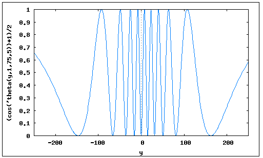

There was a mistake in the algebra ( I was tired !)
Thanks for pointing that out.
Calculating the phase in this way is not quantum, of course so it is not the right pattern. It needs a proper QFT treatment.
Here is a corrected plot.

No. I will have a dabble with this later but I don't think the two slits can be handled by the beam splitter equation. The size of the slits is not a parameter and I'm not sure if changes in the distance between them (d) affects the pattern in the way this is observed in experiments.
I made a picture from a plot. The parameters are X=75, d=3, λ=1.
