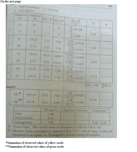

I want to study chi square test of homogeneity from any authentic source- book / website especially problems where samples are compared for more than one attribute.
Chi square test of homogeneity is a Chi square test that determines whether two or more independent random samples are from the same or different population.
What are some relevant sources?
Relevant background:
I was studying examples from random online sources before I saw this book in which a second X2
has been calculated and has been substracted from the principle X
2 (the one we usually find). This is inconsistent to the examples I saw online.
Infact we are being taught the latter process.

I checked your recommended Rice University video on Homogeneity. I also went through a number of other university websites (and videos) and all of them have solved homogeneity in the line of test of independence which appears very semantic to me. I was wondering if the process mentioned in my book (snip offs in OP) is wrong. I couldn't understand what was the need to subtract the usual X2 from the X2 obtained from adding the data points of a particular category (here yellow and green seeds) as the author has done.
