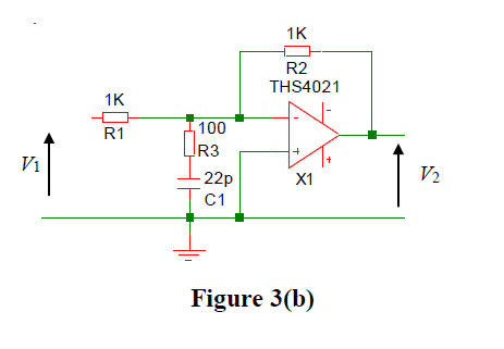

FIGURE 3(b) shows the THS4021 in a practical op-amp circuit with applied external compensation. Determine an expression for the low frequency gain of the circuit.
I really don't know where to start.
Is there a virtual Earth at the inverting input?

Big hint: " ... low-frequency gain ...".
Thanks Rude Man
I did see that in the question.
[tex] f_c=\frac{1}{2πRC}[/tex]
This is the only equation I can find for low pass RC circuit.
I think you've missed @rude man 's hint. What's the lowest frequency you can think of?
Fractions above zero?
What's the lower limit?
0Hz

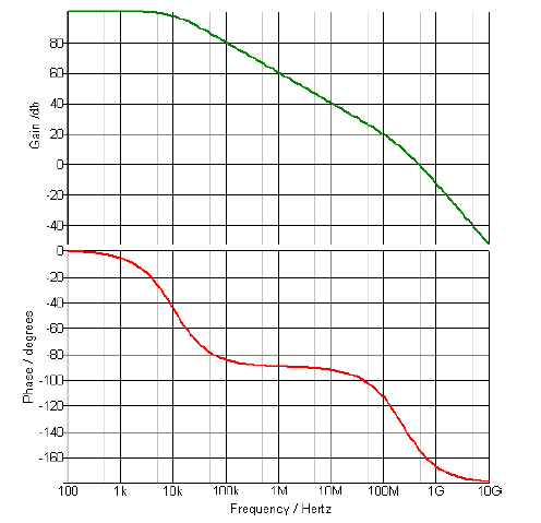

Here is some more info on the op-amp.
topcat123 said:
0Hz
Yup. So What's the 0 Hz gain of the circuit?
From the op-amps characteristic graph we can see 90 dB?
so how do I "Determine an expression for the low frequency gain of the circuit"
The op-amp is surrounded by a feedback network. Start with the ideal op-amp model and find the gain. If the result is much smaller than 90 dB then you can take the result as accurate enough. Otherwise, if what you get is a large fraction of 90 dB you'll have to introduce a more realistic model for the op-amp and go through the work of analyzing it. But that's unlikely to happen here, since I can see by inspection of the circuit that the gain won't be large...
Hint: #1: you don't need any "op amp characteristics" here.
Hint #2: what can you say about a capacitor at dc after a "long time" has passed?
Ah so when the cap has charged current through it stops.
and the general op-amp inverting input gain equation is [tex]{V_{out}}=-\frac{R_f}{R_1}V_{in}[/tex].
or [tex]A_v=\frac{V_{out}}{V_{in}}=\frac{Rf}{R_1}[/tex]
OK, what would that be using the nomenclature in your figure?
So the gain Av
[tex]A_v=\frac{V_{out}}{V_{in}}=\frac{R_2}{R_1}[/tex]
topcat123 said:
So the gain Av
Ooh, almost. Sign?
I put it in the original equation then missed it out on the second.
Because it is inverting
[tex]A_v=\frac{V_{out}}{V_{in}}=-\frac{R_2}{R_1}[/tex]
Right.
