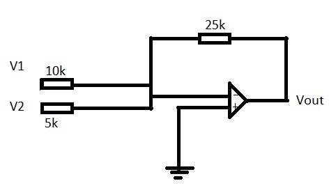

Derive the expression for the output Vo in terms of the input voltages V1 and V2?
Attached image is the cir
Inverting amp:
A=Vo/Vi=-Rf/Ri
Vout=-Rf/I_2
No idea how to go about this question with two input voltages.
If there was only one input voltage (and input resistor), what voltage would you expect to see at the - input of the op-amp? What current flows into the - input terminal of the op-amp?
The current across R1
V1/10k
The current across R2
V2/5k
So I1 is V1/10k +V2/5k?
Okay. Presuming that you understand why this is so, can you proceed to state the expected output voltage as a function of the inputs?
so Vout = -Rf*(V1/10k +V2/5k)?
You sound surprised. Yes, that is the logical consequence, is it not?
yea didn't think it would be that simple tbh, i was thinkin it would be huge although i didn't know where to start either.
