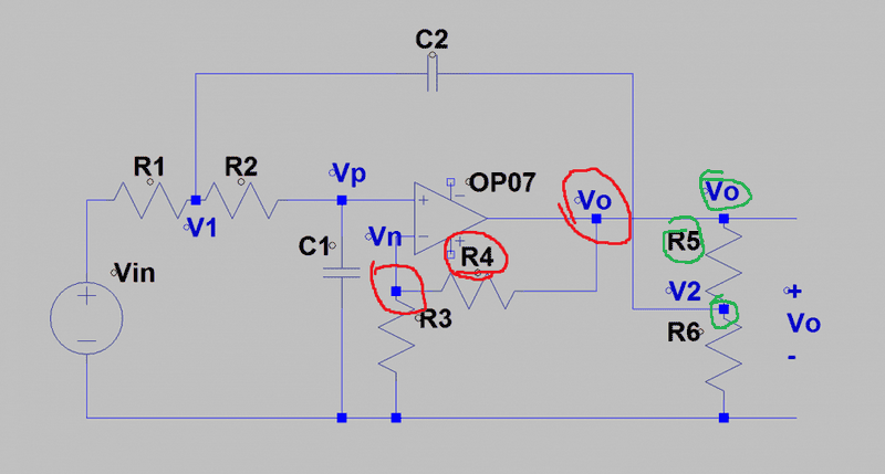

Find the differential equation for Vo
KCL
At node v1:
##\frac{V_1-V_{in}}{R_1}+\frac{V_1-V_p}{R_2}+C_2(\dot{V_1}-\dot{V_2})=0##
At node vp:
##C_1\dot{V_P}+\frac{V_P-V_1}{R_2}=0##
At node vn:
##\frac{V_N}{R_3}+\frac{V_N-V_o}{R_4}=0##
At node v2:
##\frac{V_2}{R_6}+\frac{V_2-V_o}{R_5}+C_2(\dot{V_2}-\dot{V_1})=0##
At node Vo:
##\frac{V_o-V_N}{R_4}+\frac{V_o-V_2}{R_5}=0##This is my attempt at solving for Vo:

This is where I am stuck... Are my original equations correct? Can someone give me a hint as to how to get rid of Vp?
eehelp150 said:
At node Vo:
This "equation" doesn't belong. Omit it, solve the others.
Why does this equation not belong?
What rule did you use to form it?

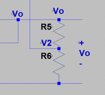

Nodal analysis
These points all have a voltage of Vo, don't they?
Show precisly how you applied nodal analysis here.
(Vo-Vn)/R4 + (Vo-V2)/R5 = 0
That can't be right. There are 4 paths for current to/from that node, including the unknown current from the op-amp's output.
You already accommodated that node to the extent possible, there's nothing more to be done here.
So I just ignore it? I'm not really understanding why...
You are forming an equation based on ∑ currents into a node = 0. That node has 4 currents, yet you are ignoring two of them and writing an "equation" based on just the other two. That's not valid.
Yes, pay no further attention to this node. You already have it covered.

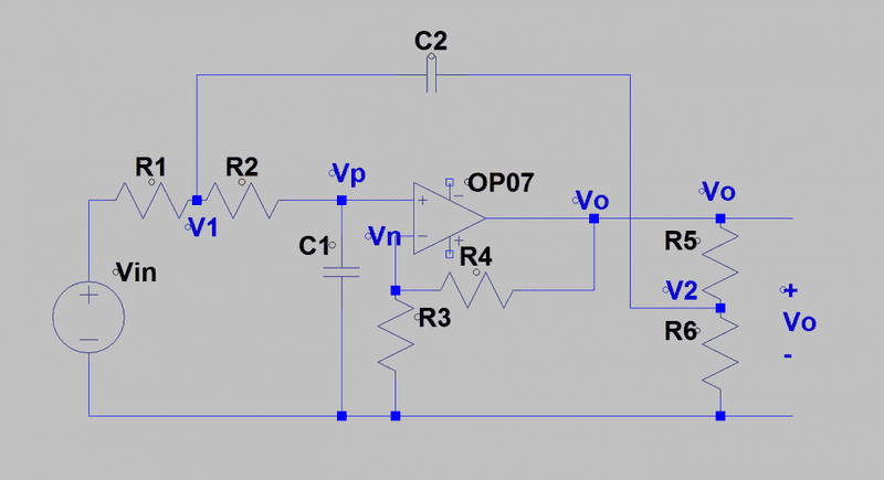

At node v1:
At node vp:
At node vn:
At node v2:
Any tips for solving these equations?
4 equations, 5 unknowns, so it's easy to solve to obtain the ratio ##\dfrac {V_o}{V_{in}}##.

NodeV1
NodeVP
NodeVN
NodeV2
I want to solve nodeV1 for VP, and then derive to get ##\dot{V_P}##
Then I can plug VP and ##\dot{V_P}## into NodeVP and solve for V2?
Am I on the right track?
