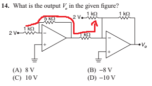

No current enters of leaves Opamp Terminals
Red line is current path.
Inverting terminal of Opamp -1 is at ground due to virtual ground concept, so Current = 2/1 = 2mA.
This current goes through feedback path and then right toward inverting terminal of opamp-2
And then it goes up as shown in arrow.
But at output of Opamp -1, let the V be Vo.
So Vo / 5 (feedback resistor of opamp 1) is not same as Vo / 1 (inverting terminal resistor of opamp 2).
Why is this so?
I got answer by: Vo = -Rf/ R1 for opamo 1. And then I found current as Vo1/1k. And then using KCL at inverting terminal of Opamo-2
But why is the underlined part wrong?
Using KCL at inverting terminal of Opamp-2
2mA = (0-2)/1k + (0 -Vo)/1k
Which gives Vo = 4V.
Not at the inputs. The output can have a current. "Infinite" current for an ideal opamp.

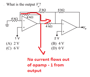

But I solved this other example using the assumption no current flows out of opamo 1 output and i got correct answer of 6V
When to take Vo has no current and Vo has current output?
It can happen that you have zero output current, but that is a special case.
Likes jaus tail
Never make that assumption, it is totally false in general.
No, that is not accurate for the Relevant Equations for opamp circuit problems.
Instead, the Relevant Equations / Assumptions should be more like these:
  • The input impedance of the + and - inputs to an opamp is infinite (no current flows in or out of the inputs)
  • The output impedance of the opamp is zero (you can draw lots of current out of the output)
  • The negative feedback of an opamp's external circuit keeps the - input at the same voltage as whatever the + input's voltage is
Now, using those rules, please write the KCL equations for each of the nodes in your opamp circuit, and solve for the unknown voltages. Please show your work. Thanks! :smile:
