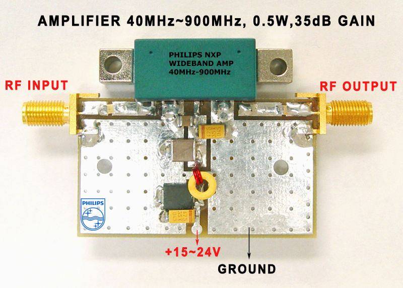

What does that mean? Does it mean you cannot purchase items from Mini-Circuits? You should still be able to find what you want at their website and then use Google to find similar items from suppliers in your country.
Karissa said:
what do you mean by canned amplifier?
A pre-assembled amplifier module. Like what you can buy from Mini-Circuits or from many other suppliers...
