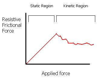

With an open diff, the torque is the same on both wheels, no matter what. When torque increases, it goes against the tire friction force. When the static friction force barrier is achieved, the tire starts spinning and the coefficient of friction goes down to the kinetic value. This means that the reaction torque goes down in proportion with this new - lower - friction force. The torque being equal on both wheels, it also reduces on the other wheel that did not begun to spin. So now, this wheel only produces a torque equivalent to the kinetic friction force, so it will never be able to reach the static friction barrier it needs to reach for the wheel to start spinning.
See, the torque at the wheels is dictated by the friction force at the tire-road contact patch, not by the torque output of the powertrain. Any extra torque sent will be converted into acceleration of the wheels (or wheel).
So, unless both tires unhook at the same time, you would need to either reduce the normal weight [itex]N[/itex] on the stationary wheel or its radius [itex]r[/itex] to increase the friction force to achieve the static coefficient of friction [itex]\mu_s[/itex] needed to resist the wheel torque [itex]T[/itex] ([itex]\mu_s < \frac{T}{Nr}[/itex]). Unfortunately, when suspension design allows lateral weight transfer, it is usually the reverse that happen weight-wise and the radius change is never enough to compensate. Worst, when the normal weight drops, the tire's coefficient of friction usually increases.
There are two forms of friction, kinetic and static. If you try to slide two objects past each other, a small amount of force will result in no motion. The force of friction is greater than the applied force. This is static friction. If you apply a little more force, the object "breaks free" and slides, although you still need to apply force to keep the object sliding. This is kinetic friction. You do not need to apply quite as much force to keep the object sliding as you needed to originally break free of static friction.
Some common values of coefficients of kinetic and static friction:
Code:
    Surfaces         µ (static)  µ (kinetic)
Tire on concrete       1.00         0.80
Tire on wet road       0.60         0.40
Tire on snow           0.30         0.20
These values are approximate.
source: http://ffden-2.phys.uaf.edu/211_fall2002.web.dir/Ben_Townsend/StaticandKineticFriction.htm
