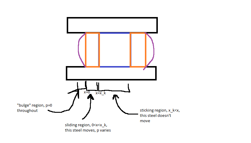

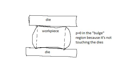

I think I've made a little more progress. At least I think I understand why the boundary condition ##\sigma_x = 2k## @ ##x=0## exists, but it doesn't explain why the author uses ##p=2k## @ ##x=0## in the lower limit of integration.
I threw in a little quick diagram to help illustrate what I think is going on. As the dies close in on the workpiece, the edges of the workpiece deform by bulging outwards. Where this bulge starts, the dies no longer touch the workpiece, so there is no pressure by the dies on the workpiece at this point, so p=0 at this point. I exagerrated the bulge in my little sketch, but my gut tells me there has to be some bulge. I can do this experiment with playdough and the playdough would bulge, so it shouldn't be qualitatively different for steel?
If my "bulging" hypothesis is correct, then since the material is yielding, ##\sigma_x + 0 = 2k## gives ##\sigma_x = 2k## at x=0 where the bulge starts. However, that conclusion contradicts the author's statement that ##p=2k## at ##x=0##. What gives?? I don't think ##\int \frac{dp}{p}## is even integrable from p=0, so I feel like I'm missing something.

Nope, nevermind my last reply, it's totally wrong. I skimmed through the slideshow to check the author's numerical results and see if p=0 at the edges, and he explicitly says ##p_{edge} = 2k## and the numerics have non-zero edge pressure.
So apparently there were typos in the slideshow, and what the author meant to say was ##\sigma_x = 0## and ##p = 2k## @ ##x=0##. Only remaining question for me is where that comes from. Why is there no stress in the x-axis on the edge of the material? If it's plastically deforming in that direction, doesn't that mean there has to be stress along the x axis??
Ok, last post I think. I think I understand why ##\sigma_x = 0## at the edge of the workpiece. Internal stresses can only push or pull on the edge layer from the inside. There's nothing outside the edge to apply any balancing forces. If there was an unbalanced force on the edge layer by the inside material, it would flow/yield until the force vanished. As a consequence, the edge layer is in uniaxial compression under the forging dies.
