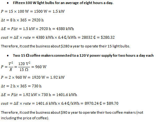

Had a bit of a hard time with this one. Anyone mind giving it a look over?
1. Homework Statement
Find the total cost for a business that operates the following for one year. Assume that the rate is 6.4₵/kWh.
· Fifteen 100 W light bulbs for an average of eight hours a day.
· Two 15 W coffee makers connected to a 120 V power supply for two hours a day each
cost = E x rate
E = pt
The total cost was asked.
Ohhhh, so the cost of the lights plus the cost of the coffee. Got it! Everything else seem right?
No, I just noticed, that it was 15 W coffee makers instead of 15 ohm.
Oh jeez. Can you tell I'm tired? I just double checked the assignment, it is in fact Ohm's and the watts in the question was an error in my typing. Thanks for catching that!
Yes, 15W for a coffee maker looked too little.
