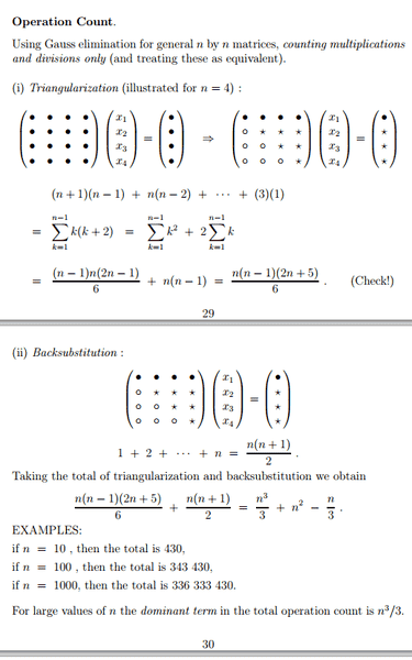

Fidn the total multiplications and divisions needed for the LU Decomp. of a general n x n matrix A, whose entries satisfy [itex]a_{ij} = 0[/itex] if [itex]j ≤ i - 2[/itex]
Assume n=5.
Also f ind the total multiplications and divisions needed for solving the lower triangular system Lg=f and for Ux=g.
I drew out the matrix to visualize it, but it's still a bit confusing. First i have to triangularize the bottom left, but there are only 4 digits which need to be zeroed due to the zero structure of the matrix. So for this portion of the LU decomposition, would there be only 5+4+3+2 multiplications needed?

Here is an exerpt from our prof notes.
I don't understand where the (n+1)(n-1) + n(n-2) bit comes from.
If a row has a zero in it, would that zero not count towards the total multiplication count?
Wish I had an answer for you, but I do not understand these notes. It does seem that he is counting the multiplications with ##(x_1,x_2,x_3,x_4)## as well as those needed to triangularize the matrix which is the only way an n+1 could get in there. It also seems that he/she is including multiplications of 0 elements, because there is no allowance for that.
