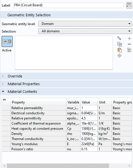

Sorry for jumping all over the place. I want to design a FEA simulation for a capacitor considering different dielectrics and other things like dielectric thickness and other geometries. I found static and optical dielectric constants which is what prompted this post. I wasn't sure what the difference was or when to use which. You mentioned DC or low frequency modeling so I just wanted to confirm that I am interested in DC. I just mentioned the high frequency switching content in case that added something else to the discussion. Looking back, I don't think it did. I'm not doing converter or component modeling considering electrical performance, but I'm more so considering material properties dependent and the physical geometry. So I think FEA is appropriate here.
I asked about DC vs electrostatic because those are two different simulation types available. You mentioned using static dielectric constant for DC simulations, but I though DC simulations considered bulk resistivity. I though electrostatic is the simulation type for considering permittivity.
Again, sorry if that made it more confusing. To sum it up, I want to simulate a capacitor that will hold a DC voltage considering various parameters such as dielectric type and different geometries using FEA. I have COMSOL and Ansys so I would be doing either DC or electrostatic.

Through DC simulation I'm able to model the conductivity, permittivity, and permeability of the plates as well as the dielectric. ESR should be able to be modeled through conductivity. Loss tangent is a function of capacitive current and resistive current so I suppose you could determine the loss tangent from simulation. If I wanted add loss tangent as a parameter, I would I have to use the RF module which I'm not using here. I'm mainly considering parameters that effect e-field intensity.
I know that e-field simulations can be done using DC or electrostatic. From my understanding, electrostatic is means there is no magnetic field present or it's slow moving and can be neglected. Do DC simulations typically consider permittivity AND conductivity whereas electrostatic assumes perfect electrical insulators and conductors and only considers permittivity?
The image attached are the parameters I have available in the current module that I'm using.
