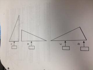

In summary, when the striking ray is held perpendicular to the prism, there are four general configurations possible (in the attachment below). Use the figure on the next page to determine analytically which of these four configurations will result in total internal reflection of the light ray. Sketch the results. In summary, when the striking ray is held perpendicular to the prism, there are four general configurations possible. One of the configurations results in total internal reflection.
everlasting89
When the striking ray is held perpendicular to the prism, there are four general configurations possible (in the attachment below). Use the figure on the next page to determine analytically which of these four configurations will result in total internal reflection of the light ray. Show analytical work and try each setup. Sketch the results.
sin θ = (n1 / n2)(sin 90)
Angles of the prism: 90, 59, and 31 degrees
Found the critical angle:
sin θ = (1.5/1)(sin 90)
sin θ = (1.5/1)(1)
θ = 41.8 degrees
And I know that for total internal reflection the angle of incidence must be larger than the critical angle. However, I am stuck on what (and how) to do next.
Any help is much appreciated!

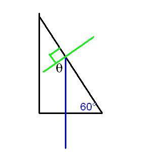

Draw the rays inside the prism and figure out the angle of incidence when the ray strikes the other side.
ehild
Thanks, ehild. The prism is 60, 59, and 30 degrees. How do I determine what the rays inside the prism look like?everlasting89
everlasting89
You mean 90 instead of 59, I guess :smile:
The ray enters at the first surface at zero angle of incidence (perpendicular to the plane) so it does not change direction in the prism. At what angle with respect to the normal does the ray strike the other surface? It is just simple geometry. I draw one of the configuration. Is the angle of incidence θ smaller of larger than the critical angle of 41.8°?
ehild
Ok, I think I get it. Thanks! So the incidental angle would be 30 degrees which is smaller than the critical angle of 41.8. Thus, it will not result in total internal reflection.
