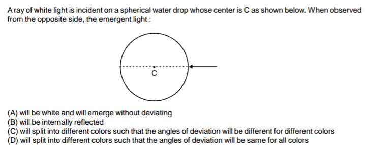

1. Homework Statement
[/B]
I know that if white light is incident on a triangular prism , then lights of different wavelengths are deviated by different amounts and dispersion occurs .
But I am not sure what would happen in this case where we have a spherical drop .
Please help me understand this conceptual question.

What law determines the deviation?
Likes Jahnavi
Snell's law .
OK . I got your point . But what if the incident ray is at some angle to horizontal ?

A is correct answer. if it the spherical considered as regular.if it is not the answer be B.
What is your reasoning ?
draw perpendicular line for the circle it will goes through the radius of the circle and the normal also in the line of radius.and the light incident on spherical through radius.
i think u know that any of light ray do not deflect when incident through normal line
What do you mean by above ?
@haruspex , what would happen if ray is incident at some angle ?
If the rain drop is regularly spherical then there is no colour dispersion occur.
Jahnavi said:
Snell's law .
Do you mean, at some angle to the normal? Then there would be deviation, dispersion, and maybe internal reflection.

Yes, but I don't think that is what B is referring to.
sanujan said:
nothing law is necessary for determining the deviation.
Snell's law gives the answer. It might or might not be necessary to appeal to that.
