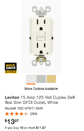

I'd suggest you make yourself an extension cord, 3 conductor of course, with a GFCI receptacle at the end.
I use a simple outlet box akin to this
mounted with screws through the back to a 1X4 plank about a foot long. Mount it near one end.
Mount the GFCI receptacle in it
and wire to a cord & plug of convenient length.
Remember
black wire is "hot" and goes under the brass colored screw, same side as shorter slot
white wire is "neutral" and goes under the silver colored screw, same side as longer slot,
both at top of receptacle marked "Line" .
Green wire goes under the green screw on the receptacle's metal frame.
Now you have an outlet that provides personnel protection. But not overcurrent protection.

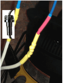

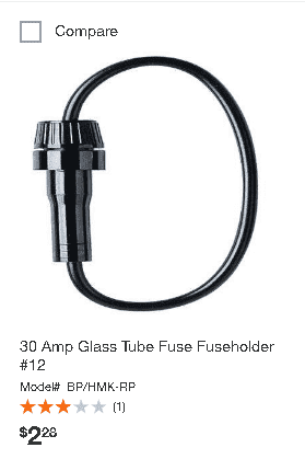

I'd accomplish overcurrent protection by placing an inline fuse holder in the cord you make for the main coil.
One of these
here
Place it in the black wire, or if using lampcord as in your link place it in the wire going to narrow prong on the plug.
Be sure to solder and heatshrink all your splices. Of course neatness is a must, check there's no loose strands of wire and no sharp points sticking through the insulation.
Now, put perhaps a 10 amp 250 volt fuse in your holder so you won't trip any breakers or make big sparks.

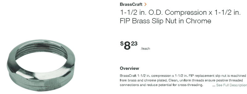

For a ring to throw i think i'd try one of these and use 1½ inch sink drain pipe to encircle my magnetic core.

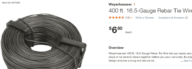

Ceiling tie wire or rebar tie wire is cheap. Smaller gage will have less eddy currents.
Straightening small 16 gage will be easier than larger 12.
I hook one end around the trailer hitch on my car, other end around something immobile . I have a steel bar embedded in a large rock for just that purpose but another car would work as well. Most cars have a tow hook under the bumper.
Pull just enough to feel it stretch a teeny bit - as soon as it starts to yield it'll become quite straight. Relieve tension and cut into lengths.
That soft iron wire cuts easily with a wire cutter or lineman's plier..
Of course stand clear while stretching ! If it snaps it'll fly back unpredictably.

I really liked the rebar tie idea for the inductor material. It's a very low gauge which is great for eddy currents as long as they are properly insulated. They also appear to be annealed already, and don't have to be thrown in an over for a few hours.
