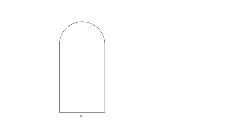

A figure is made from a semi circle and square. With the following dimensions, width = w, and length = l.
Find the maximum area when the combined perimiter is 8 meter.
I first try to construct the a function for the perimeter.
2*l + w + 22/7*w/2 = 8 - > l = 4 - (9*w)/7
Next I insert this into a function which is suppose to define the area.
f(w) = l*w + 1/2*22/7*(w/2)^2 and substitute l with l = 4 - (9*w)/7
which results in f(w) = (4 - 9/7*w)*w + 11/28*w^2
I find the derivative of this function f'(w) = -(25*w)/14 + 4 and solve f'(w) = 0 and find that w is suppose to be 2.24 m
However the solution manual says w = 1.86 m.
So what am I doing wrong?

Thank you for your reply,
The drawing in the textbook look like this. Any thoughts on what I am doing wrong? In regards to my calculations?

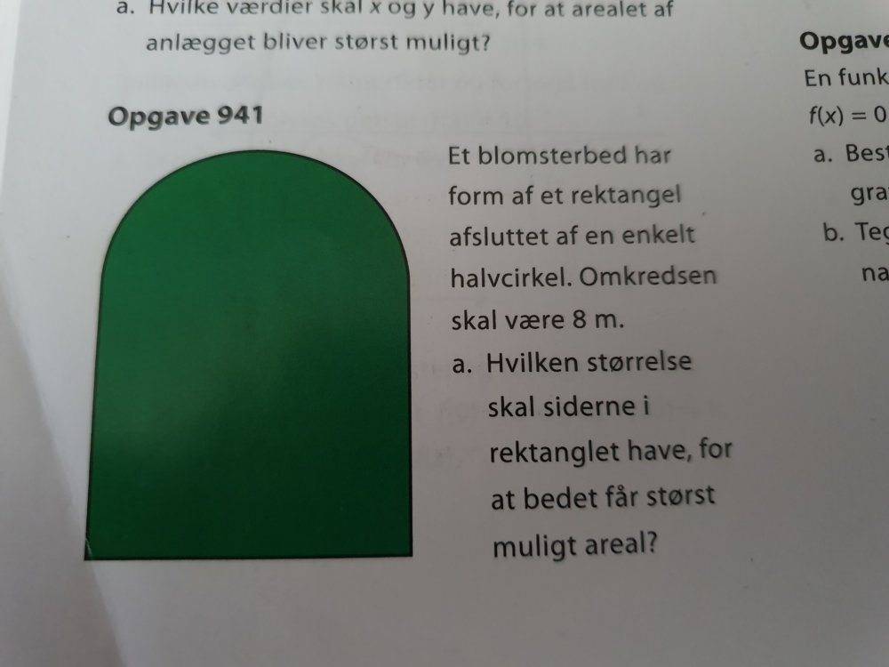

I can't find what you doing wrong, wolfram also says that w=56/25. My only doubt is regarding the scheme, is that an exact image from the problem at the book?
Thank your answer, the image in the textbook in the included file. The text is in danish, but simply says: A flowerbed is comprised of a semi-circle and square. The perimeter of the entire must be 8 meters in total.
How long does the sides of the square part have to be? To get the maximum area of the square part of flowerbed?
And I constructed a function for the perimeter in initial post post. Calling the length l and width w. Next isolated with respect to l, and next found the area function. f(w) which calculated the derivative of. and solved the equation f'(w) = 0 and found w and used this result to find L.
Can it be an error in the problem? Or an error in the solution manual?
unfortunately I don't know Danish to read for myself, but does it say "the maximum area of the square part" of flowerbed?. IF so I think it asks to maximize the area of the rectangle with sides l and w, that is to maximize ##l\cdot w##, ignoring the area of the circular part.

You confused things by saying "square". If w is not equal to l, that is not a square. Taking w to be the length of the top and bottom of the rectangle and l to be the length of the right and left sides, then the circle has radius w/2. The distance around the semicircle is [itex]\pi w/2[/itex] and the distance around the three sides of the rectangle is 2l+ w. So the total distance around the figure is [itex]\frac{\pi w}{2}+ 2l+ w= 8[/itex]. The area of the semicircle is [itex]\frac{\pi w^2}{4}[/itex] and the area of the rectangle is [itex]lw[/itex]. The problem is asking you to maximize [itex]\frac{\pi w^2}{4}+ lw[/itex] subject to the condition that [itex]\frac{\pi w}{2}+ 2l+ w= 8[/itex]. The simplest way to do that is to solve [itex]\frac{\pi w}{2}+ 2l+ w= 8[/itex] for l so that you can write [itex]\frac{pi w^2}{4}+ lw[/itex] as a function of w only.

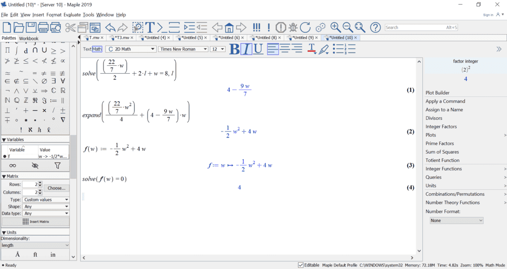

Dear HallsoftIvy,
If I try to solve in Maple, then I get that w is 4?
Should be rectangle. 2.24 is correct, book answer wrong.
Check the half-circle area expression...
