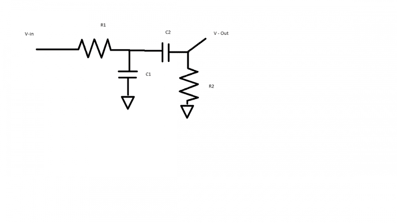

I am assigned to design a circuit that peaks voltage at 10kHz and is less than half peak voltage at 3k and 30k. Only capacitors and resistors are allowed. The circuit I'm using is attached. I end up with
##I_0 = [\frac{-R_2\omega^2C_1C_2 + [C_1+C_2]R_1R_2\omega^3C_1C_2 - R_1\omega^2[C_1+C_2]^2 - R_2\omega^2C_2[C_1+C_2]}{(R_1R_2\omega^2C_1C_2-R_1\omega[C_1+C_2]-R_2C_2\omega)^2 +1} + \frac{-R_1R_2^2\omega^4C_1^2C_2^2 + R_1R_2\omega^3C_1C_2[C_1+C_2] +R_2^2\omega^3C_1C_2^2 + [C_1+C_2]\omega}{(R_1R_2\omega^2C_1C_2-R_1\omega[C_1+C_2]-R_2C_2\omega)^2 +1}i] V_{in}##
Which I just realized I have I naught and not I2 (running through R2), so I need to fix that.
I'm assuming there are some tricks to picking values to accomplish this? We're staying in the peco-micro range for caps and <1M for resistors, just for accessibility.
If I make a spreadsheet trying to capture all the variance, it's too huge. I'm already out to DZ and only have r1 + w, and r2 + w variance.
I don't think I'll even be able to solve for ##\frac{d}{d\omega} \text{Transfer} = 0 ##
Since the resistors don't seem to change much of the frequency response (I assumed they might have to do with the width of the peak, as in an RLC Q-factor), I should be able to simplify a little, but I think the key will be in my capacitance ratios.
Thanks.

Sure it's reasonable. C1 is part of a low-pass so it's going to have a really high impedance at lower frequencies because C1 dominates the voltage divider until you get to the cut-off frequency. Approximate it as an open circuit and analyze what is left at the turn-on frequency of the second stage (3kHz). We're justified in doing this by the fact that the parallel equivalent of an extremely high impedance in parallel with a low impedance branch will be approx equal to that low impedance branch.
$$lim_{X_{1}→∞}X_{1}||X_{2}=lim_{X_{1}→∞}\frac{X_{1}X_{2}}{X_{1}+X_{2}}=X_{2}$$
The impedance of C1 should not become significantly low until you get near 30kHz. Try it, take C1 out of the circuit and analyze it with only R1,R2, and C2 at 3kHz.
Also consider the limit of this addition ##lim_{X_{2}→0}X_{2} + R_{2}=R_{2}##. The value of C2 won't be significant compared to R2 at the high frequency cutoff (30kHz). It could be approximated as a short.

Just consider the network as two voltage dividers that are divide-by-two. That should give you a broad peak around 9.5 to 10kHz. Tweak values as needed.
Make Xc1 equal R1 at the low frequency,
and Make Xc2 equal R2 at the high frequency.
Xc2 and R2 should be 10 times Xc1 and R1.

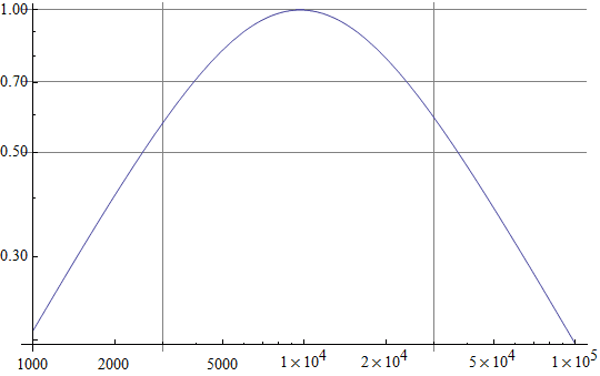

Is this a homework problem? Where did you get that huge expression in post #1? Did you derive it yourself? Shouldn't it be Vout/Vin rather than Io/Vin?
This circuit you're using has only 2 capacitors, so it's a second order network. Its transfer function can't have ω raised to the 4th power.
Using the circuit you have (2nd order) you won't be able to get a half amplitude output at 3 kHz and 30 kHz. Using R1 = 1000Ω, C1 = .0165 μF, R2 = R1*20 and C2 = C1/20, here's the response you get:
You'll notice that the amplitude is not less than 1/2 the peak at 3 kHz and 30 kHz. You won't be able to do better than that with two resistors and two capacitors.
Can you think of something relatively easy to do that would give you a faster cutoff rate?

Well, my transfer is 2nd order before I multiply by the complex conjugate. Then it becomes O(2)xO(2)= O(4)
Try plugging in the values for R1, R2, C1, C2 I gave and see what you get.

Here's the important hint; the "something else" is to cascade two circuits like you are using now. In other words, use 4 resistors and 4 capacitors.

It looks like you are taking a very analytical and overly complicated approach to solving this problem. Using optimization and variance is overkill for this type of problem. your making it hard on yourself. The architecture of the circuit is what really sets the gain values. solving this comes down to solving 2 equations.
just a hint. When doing frequency analysis it will often help to use the s operator from laplace. if you recall s=jw.
when analyzing the circuit, the transfer function is found seen below
Vo/Vin = [SC_2R_2 ] / [ S^2C_2^2R_2_2+S(2C_2R_2+C1R1)+1 ]
Now let's get to the best way of solving. do you recall what poles and zeros are? very simply a pole will cause the gain to decrease 10 dB per decade as frequency increase. a zero will cause the gain to increase 10 dB per decade as frequency increases.
this is a bandpass circuit given your requirements. There is one zero, so C2 and R2 will set your zero. This zero will control the rising part of the circuit. remember that it is a zero at the origin. because we don't have a voltage requirement for 3khz (other than half of 10 khz) the value of c2 and r2 don't actually matter (relative to the zero that is).
you need a 2x magnitude difference between the 3k and 10k points (about 6 dB). the same goes for 10k to 30k.
if you look at the poles we have a second order response (2 poles). We want to put these 2 poles at 10 khz to ensure the voltage peaks there. so the poles will be at
10+xj and 10-xj. with x being some number. normally this value matters, but in our case it doesn't matter at all
our pole equation is S^2C_2^2R_2_2+S(2C_2R_2+C1R1)+1. let's use the quadratic equation to solve for S=10

wait. what is your actual assignment. Were you given that circuit, or were you given the task the meet the requirements, and you chose that circuit?
There are better topologys to solve this problem. Like the electrician stated you need to figure out what order filter you need.
  • #34
I chose this circuit to meet the requirements. So add in more stages to smooth the required points?
I don't see how you got this. Even so, you have a complex denominator, and I've never seen it left that way. Shouldn't you multiply by [s^2 C_2^2R_2^2 + 1 - s(2C_2R_2 +c_1R1)] / [s^2 C_2^2R_2^2 + 1 - s(2C_2R_2 +c_1R1)] to make the denominator real?
It's a fairly independent project, so we were given the requirements and left to choose a circuit ourselves.
As for how I arrived at the transfer function I have:
##I_0 =\frac{V_{in}}{R_1 + \frac{1}{\frac{1}{z_1}+\frac{1}{z_2 + R_2}}}## and algebra.
The step before subbing in z's you end up with
##\frac{V_{in}(z_1 +z_2 + R_2)}{R_1(z_1+z_2+R_2)+z_1(z_2+R_2)}##
I've seen S used, but I always just end up subbing in z_1 = 1/iwc_1 once I get to an appropriate form to do so.
  • #35
Your image in post #1 of the circuit you're analyzing doesn't show Io, so I can't comment about the correctness of your expression:
Is Io the current in R2? If it is, then your expression is incorrect.
If you will show the step by step procedure you used to get it I can help you find your error.
Once you have a correct transfer function, how will you verify that it meets your problem requirements? I suppose you would evaluate the transfer function at 3 kHz, 10 kHz and 30 kHz. Do you know how to produce a plot of the transfer function vs. frequency?
