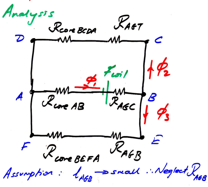

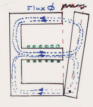

The aim is to optimize this actuator to get the maximum force from it. Here is the circuit diagram below:
Length of air gap top (Ragt in diagram) = 0.5 mm
Length of air gap centre (Ragc) = 0.25 mm
Current in coil = 0.8 A (I calculated it), current in coil must be less than 1A

Will the flux divide equally ?, my guess is no because the air gap reluctance's are different
To get the drop in RcoreBCDA, I use F = Hl, now my question is will the mean path length(l) run from ABCD ?
Lastly, any guidelines on how to solve for the magnetic fluxes and mmf drops ?, I did attempt it but not sure it it's correct
Any help will be greatly appreciated, this my design project and it's due very soon
Right.
Use mmf = Σ RΦ (which = H l but I don't think you need it). R = reluctance.
Lastly, any guidelines on how to solve for the magnetic fluxes and mmf drops ?, I did attempt it but not sure it it's correct.
You drew a good equivalent circuit; use it.
BTW for mmf you need more than the current. what is mmf for the coil?

Here's what I did:
Since magnetic circuits are analogus to electrical circuits, I used KVL and made two equations like this,
Top loop:
Ftotal = (phi1*RcoreAB) + (phi1*Rgc) + (phi2*Rgt) + (phi2*RcoreBCDA)
Bottom loop:
Ftotal = (phi1*RcoreAB) + (phi1*Rgc) + (phi3*RcoreBEFA)
If I simplify by equating them and saying that RcoreBEFA = RcoreBCDA, I get this expression
phi3/phi2 = (Rgt/RcoreBEFA) + 1
I'm not sure if that's right ?, also will RcoreBCDA = RcoreBEFA ?, thanks

Well, that wasn't my suggestion.
My suggestion amounted to RcoreBCDA = RcoreBEFA = RcoreAB = RAGB = 0. That's because the permeability of rolled steel is >> permeability of air.
OK, so look at your equivalent circuit in this (totally justifiably) simplified way. What do you think the flux in gap AGT will be?
Will it be zero ?, because if their's no reluctance in the bottom then all the flux would flow their
Right! But this assumes the bottom gap reluctance RAGB really is zero which it really isn't, but I guess your teacher said to assume it's zero so it's zero! :smile:
So how does that help me get the mmf drops and fluxes of the circuit ?
Your equivalent circuit answers that question. The mmf drop will be entirely across the middle gap. Flux = mmf/reluctance of gap.

For the top air gap I chose randomly 1.2 mm, then by using similar triangles I got the center gap to be 0.6 mm, like this
lgt/40 = lgc/20.....where lgt = 1.2
Solving for lgc, I get 0.6 mm
The reluctance = L/u*a
= 0.6/(4pi*10^-7)*10*16, where 10*16 is the area
= 2.98*10^6 At/Wb

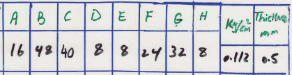

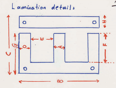

Oh and these are the dimensions:
