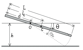

The amount a drumstick bounces after hitting a surface depends on where you place the fulcrum along the stick. I'd like to understand why.
When a drummer holds a drumstick, the fingers form what's called a fulcrum. The stick pivots about this fulcrum. This question is not about striking from the hand with the drumstick. Instead, the drumstick is held horizontal and then allowed to fall due to gravity.
A drumstick has two ends. The tip is the end that strikes a surface. The other end is the butt end.
If you place the fulcrum at the centre of mass, the stick doesn't move when you let go of it (it's balanced). If you place the fulcrum on the tip side of the centre of mass and then let the stick go, the tip goes up instead of down as the butt end falls. If you place the fulcrum at the butt end of the stick, there is zero bounces. So for this work the fulcrum has to be somewhere between the centre of mass and the butt end of the drumstick.
There is a magic point somewhere between those two locations where the amount of bounce is maximum. A loose definition of maximum bounce is that the drumstick will have more bounces before coming to rest. Intuitively it feels like some aspect of rotation is balanced, but I don't know what.
This is not my pic, but it shows what the setup should look like:
The centre of mass is at C. The pivot is at O.
A drum stick is an odd shape. A cylindrical rod works just as well and I did some testing with a piece of 1/2" dowel rod. Using the above picture as a reference:
$$L = 450mm$$
$$l_c = 225mm$$
$$d = 155mm$$
With $$d=155mm$$, there is maximum bounce. It may not be a coincidence that $$\frac{d}{l_c} \approx \frac{2}{3}$$.
The pic comes from a paper called "A simple mechanical model of the drumroll", but it develops a model for the time between bounces based on changing d, h, and the surface elasticity. I didn't grok anything in the derivation that answered my question.
The stick appears to be a compound pendulum, where its period depends on the pivot position. The period of the bounce mechanism, as with a trampoline, depends on amplitude. So I imagine the drummer adjusts the pivot position so that the period of the compound pendulum matches the period of the bounce at the particular amplitude he is using.
The effect will also depend on where the drum is struck. There are many possible modes of oscillation that can be excited in a membrane by an impulse. Think impedance matching. There will be sweet spots, and dead spots on the surface, that offer different reflection coefficients, to the drumstick configuration used.
I will upload something with varied positions so you can help me with this.
I just wanted to clear up some confusion here.
This maximum bounce fulcrum position is purely a function of the stick. It will be in a different location on different sticks. It's not something the drummer adjusts to change the effect.
This is not playing a drum. It is simply determining the best place for the fulcrum on the stick given the constraint of maximum bounces.
Consider the surface a practice pad. This is a uniform, high rebound, gum rubber surface.
I looked up the compound pendulum and it seems like a good fit. However, there's lots of talk about radius of gyration and I haven't been able to understand that. I came across a patent for matching two wooden drum sticks that involved the radius of gyration so I feel that this is on the right track. Also that paper I mentioned used the radius of gyration.
The formula I keep seeing for the period of oscillation for a compound pendulum is:
$$ T = \frac{1}{2\pi}\sqrt{\frac{k^2 + h ^2}{gh}}$$
Where h is the distance from centre of mass to the pivot and k is the radius of gyration. I think maximizing this period is a good place to start. With ##h^2## in the numerator and ##h## in the denominator I'm not sure what to make of it.
If anyone wants to read that paper, it's here.

I don't know what I'm doing here, but I went back to that paper which seems to be the closest thing to what I want to know. The thing that determines the bounce is the kinetic energy. From the paper:
We describe now the bounce of the stick
according to a simple inelastic collision model in
which the angular velocity ω i after the rebound is
expressed as a fraction α, to be interpreted as the
coefficient of restitution
It occurs to me that the highest bounce must also be the highest kinetic energy. The drawing again for easy reference.
Let's start with the kinetic energy
$$E_{kinetic} = \frac{1}{2}I_O\omega^2 $$
The paper derives the angular velocity as:
$$\omega(\theta) = \frac{1}{K_O}\sqrt{2g(l_c -d )\sin\theta} $$
Interestingly, ##d = l_c## means ##\omega = 0## regardless of ##\theta##. The pivot at the centre of mass means it shouldn't fall. However, if ##d \gt lc## then there's a negative square root.
Another equation:
$$I_O=mK_O^2 $$
And I should be able to combine them:
$$E_{kinetic} = mK_O^2[\frac{1}{K_O}\sqrt{2g(l_c -d )\sin\theta}]^2 $$
$$E_{kinetic} = 2mg(l_c - d)\sin\theta $$
And that doesn't look right to me. If ##d \geq l_c## the kinetic energy is negative. If ##d = l_c## then the kinetic energy is zero. Based on this equation, the kinetic energy is highest when ##d = 0##. That might be true, but the stick won't bounce when the pivot is at the butt end.
I found another equation in the paper that, using small angle approximation, says the acceleration is:
$$ \frac{d\omega}{dt} \approx \frac{(l_c-d)g}{K_O^2} $$
Now ##K_O## also depends on ##d##:
$$K_O = \sqrt{\frac{2l_c}{3} -2l_cd + d^2} $$
That also came from the paper. Plugging it into the acceleration:
$$ \frac{d\omega}{dt} \approx \frac{(l_c-d)g}{\frac{2l_c}{3} -2l_cd + d^2} $$
I threw that equation into a graphing website (desmos) and it wasn't a function that had a maximum. So it's not peak acceleration either.
I guess I'll study that compound pendulum more next.

I've definitely been looking at this wrong. The starting diagram should be with the stick tip at an angle already in contact with the surface. From here the surface applies an impulse to the stick tip. Now it becomes a question of how to maximise the height of the tip for any impulse. Or rather maximise the potential energy as it comes to a stop.
Previously I was rather speculating about the deformation of the object having an impact, which is not considered in the center of percussion derivation or my simple analysis above. It is an additional factor, but I don't know how relevant it is for a drumstick.
It could be relevant for drum strokes that have more force behind them. In this example of dropping the stick from horizontal, I'm not so sure. That paper I mentioned before got some good correlation between how many times the drumstick bounced in simulation vs experiment when falling from horizontal due to gravity.
InTheWorks said:
In what way is that pivot location optimal for the number of bounces?
A.T. said:
The less reactive force your hand has to apply on impact, the less energy dissipation you have, because your hand is not very elastic (has lots of damping and dissipation).
I think you should investigate the short time, while the tip of the stick is in contact with the membrane. If the tip contact time is longer, there will be less high frequency sound generated, that would waste energy. To lengthen the duration of contact, match the impedance of the tip to the impedance of the membrane.
Let's take the hand out of the equation. The Lego model I built does the same thing and there is no hand to dampen or dissipate.
Earlier you wrote that the angular acceleration was:
$$\alpha = \frac{\tau}{I} = \frac{F}{m} \frac{6}{L}$$
I've been picking my brain trying to understand how that comes to be.
Questions:
1. why does the angular acceleration depend on the linear acceleration like that?
2. where does the ##\frac{6}{L}## come from?
Yeah basically I can't understand any of it.
I have been giving this a lot of thought. The reason for a specific pivot to yield the most number of bounces must have something to do with the angular velocity at impact.
I tried looking for that before, but I think I made a mistake. The first mistake was equating kinetic to potential energy as written in the paper. The equation in paper for potential energy is:
$$E_{potential} = mg(l_c - d)$$
I think, perhaps, there is a missing ##\sin\theta##. Because ##l_c-d## becomes the hypotenuse of a right angle triangle (from the pivot to the centre of mass) with respect to the original horizontal position. So the total distance that the centre of mass fell is:
$$E_{potential} = mg(l_c - d)\sin\theta$$
Now, can set that equal to kinetic energy:
$$ E_{kinetic} = I\omega^2 = mK_0^2\omega^2 = mg(l_c - d)\sin\theta$$
and rearrange for ##\omega##:
$$\omega = \frac{1}{K_O}\sqrt{g(l_c - d)\sin\theta} $$
If I put that into desmos, there is a maximal value over ##\theta## as ##d## changes.
One more simplification will change the final angular velocity into purely a function of ##d##. ##\omega## at the start is 0 and ##\omega## will be maximum at the angle where the tip contacts the surface. That angle is ##\sin\theta = h/(L - d)## where ##h## is the height of the pivot and ##L-d## is the length of the stick below the pivot.
$$\omega_{final} = \frac{1}{K_O}\sqrt{\frac{gh(l_c - d)}{(L - d)}} $$
The final form for the final angular velocity as a function of ##d## is:
$$\omega_{final} = \frac{\sqrt{\frac{gh(l_c - d)}{(L - d)}}}{\sqrt{\frac{L^2}{3} + d^2 -Ld}} $$
I can graph that and find out that the maximum final angular velocity occurs when ##d = 0.12m## for ##L=0.4m## with a rather coarse step size. The ratio of d/L is 0.3. If I try to narrow down the value of ##d##, it gets smaller. That means it's less than 1/3 which does not match the centre of percussion exactly.
