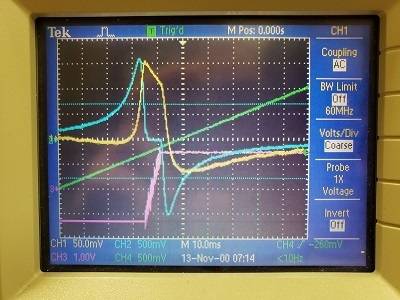

I took some pictures at lab to demonstrate what I mean by "grab" the peak:
Scanning the laser through the cavity resonance:
Now, scanning the laser *while* locking the servo:
The yellow trace is the transmission through the cavity, the blue signal is the demodulated Pound-Drever-Hall signal, and the pink is the output of the servo (what goes to the laser modulation port).
Notice the effect of the lock on the PDH (blue) signal. When the laser frequency is inside the lockable range, the servo clamps the error signal voltage to zero. When the error signal is outside the lockable range, the servo output rails to the positive or negative side (note: the pink channel's zero is offset from the rest), see the little markers on the left side of the screen).
When I talk about the "setpoint" voltage, I mean what value the servo clamps the voltage at. In the case of these pictures, that voltage is 0 (since the blue signal is clamped to 0V when the scan is in the lockable range). I could have instead chosen the setpoint at 500mV, and then you would see the PDH signal would be locked there instead of at the center of the line.
