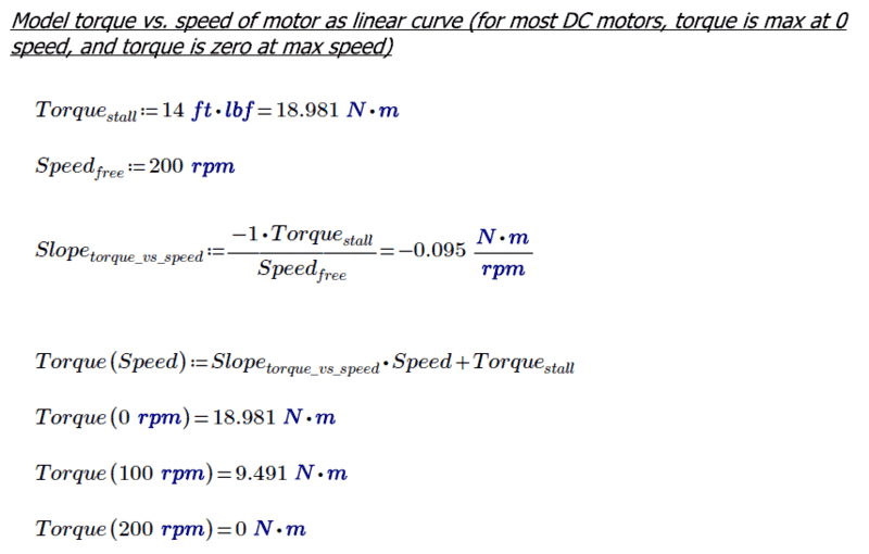

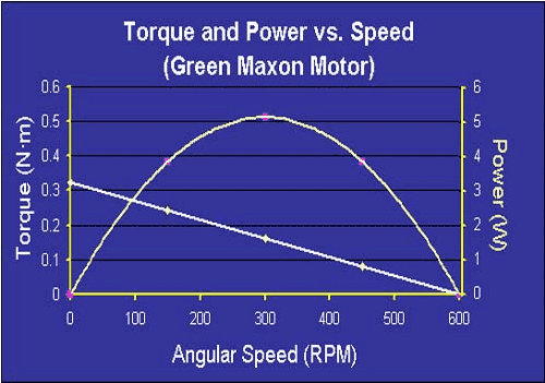

Christian Hoermann said:
As I mentioned before, I took the values for rpm, torque, and current and devised my own. However, this is not very accurate because it assumes linearity (which is a pretty bad assumption from what I've read).
From what I understand, this is a valid method for modeling a DC motor's torque vs. speed curve. See here: MIT- Understanding DC Motor Characteristics (Section 3.1, Torque/Speed Curves)

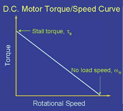

From MIT website:
I instructed excel to create the data along the increments of 10 rpm. That is why the torque and current aren't pretty numbers like the rpm. We knew that our internals cannot handle more than 20 A of current (wire thickness and fuses), so we chose the closest amount of current to that on the chart (20.16A) and got the rpm and torque from there.
The important thing to keep in mind is that because the motor's torque vs. speed curve is linear, and motor's power output is a product of the motor's torque and speed (a.k.a. the area under the torque vs. speed graph), the Power vs. Speed curve is an upside-down parabola with a maximum in the middle. The most important takeaway of this is the motor's maximum power output does not occur at the same point as max torque.
See here: Section 3.2: POWER/TORQUE and POWER/SPEED CURVES

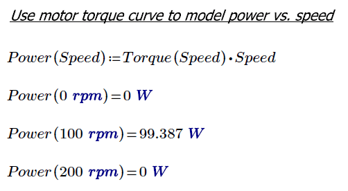

When I do the math and calculate power as a function of speed using the AndyMark motor's specifications for stall torque and free speed, the math works out. When you create a linear torque-vs-speed equation with appropriate max torque and free speed, the maximum power for this DC motor is 100 W at 100 RPM (half the free speed), and the motor's torque at peak power output is 9.491 N-m (1344 in-ozf). Current draw at 100W should be around 8.3 amps if its a 12V motor.

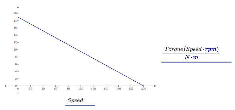

Building Torque vs. Speed equation:
Torque vs. Speed plot:
Power vs. speed equation:
Power vs. Speed plot:

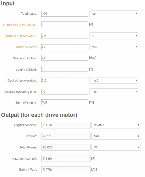

For more information, you should also take a look here: Robot Shop: Drive motor sizing tutorial.
This website also provides a robot drive motor sizing tool here: Robot Shop: Drive Motor Sizing Tool. The calculator appears to provide numbers that are in-line with the estimates I've made so far, for what it's worth. Note that the drive wheel radius needs to be large based on your available power output and rpm at peak power out (I put in 24 deg. incline since that's the max incline you can ascend at 2.0 m/s with 400 W of peak power output) [Edit: This also assumes 100% efficiency in your drive system, which I would recommend using something lower like 65% for some safety factor]:

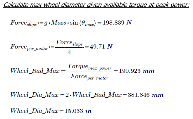

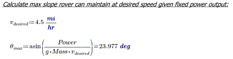

Max incline based on power output:
Robot wheel size based on peak power torque from my calculations:
