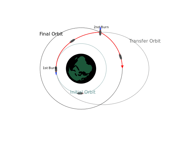

To clarify:
are you trying to do this kind of transfer:
Or this:
(in your scenario the 'initial orbit' is the Earth's surface, and the '1st burn' is the projectile being shot)
The first type of transfer requires lower delta V, if that's what you're looking for. It's also easier to calculate.

Bandersnatch said:
To clarify:
Or this:

Are there names for those 2 types?
First one is called Hohmann transfer orbit. It is a special case of the second type, which is a more generic two-impulse transfer. I would swear there was some name attached to the non-Hohmann type, or at least to its flight time-minimising case, but for the love of me I can't remember what it was.

This changes for very wide target orbits, where a bielliptic transfer becomes cheaper, especially (!) if you don't have to "pay" for the first burn.
That is what I meant with "up first" (=not an orbit at surface level).
Ah ok, VERY interesting!
So I might need to make a spreadsheet using this and compare the two to find the lowest second burn value for a reasonable LEO.. (I'm thinking between 300 and 600km)
