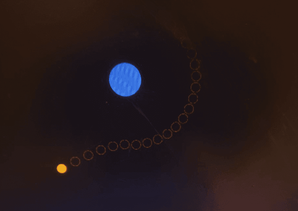

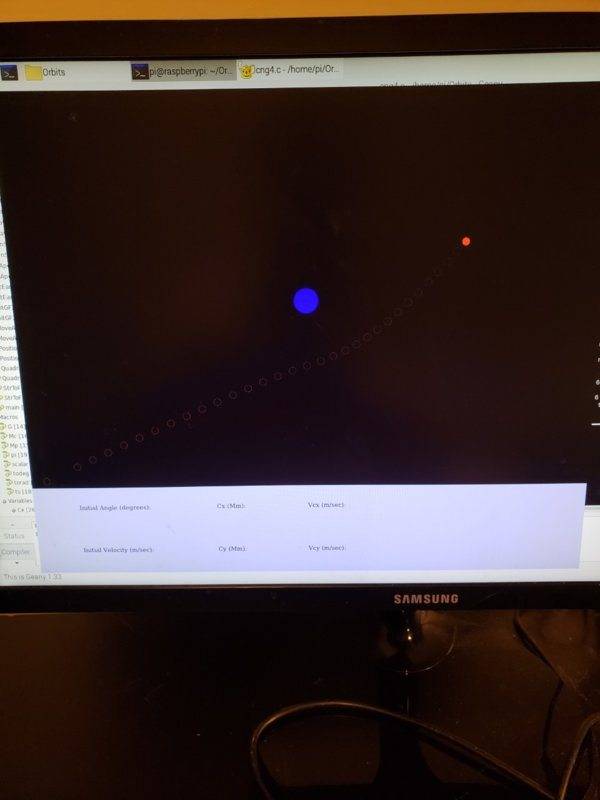

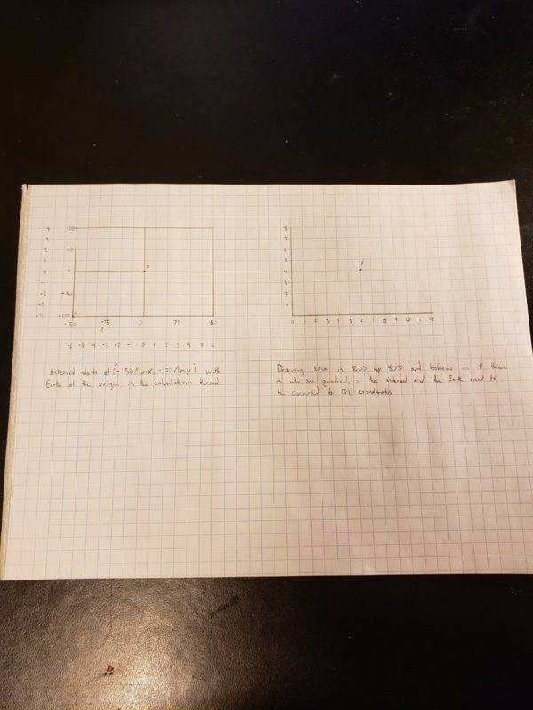

My drawing area is 300 Mm by 200 Mm, which I scale down to 1200 by 800. From a calculations perspective, I treat this as if there are four quadrants. Unfortunately, the graphics library that we have to use, initializes a drawing area that only behaves as if there is one quadrant (Q1) so I have to "shift" the Earth and the position of the asteroid relative to the Earth to Q1 for the purpose of displaying the graphics. This may be a source of error, but I believe that I have this part correct. The Earth is initially at the origin, and it is shifted to the middle of the drawing area (600, 400). Since the position of the asteroid will always be relative to the Earth, I take the x and y coordinates of the asteroid and add 600 to the x coordinate and 400 to the y coordinate to get the equivalent Q1 coordinate for use in the graphics thread.
Attached is an output of the program where we can see the path of the asteroid being altered by the Earths gravity (25 degrees initial angle with 8000 m/s initial speed). The second attachment is of my four quadrants for the calculations thread and the one quadrant for the graphics thread.
If you have any other questions, please let me know. I am making this thread in hopes that someone with more knowledge about this stuff can review my math and help find any errors that exist. Thanks for reading.

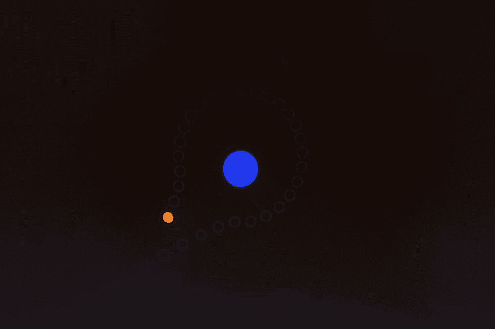

These changes I believe make sense. Attached is an image of the path the asteroid takes with 30 degrees as the initial angle and 8000 m/s as the initial speed. If I leave the angle as 30 degrees and increase the initial speed, similar effects happen, but instead of looping around, the path is altered and the asteroid keeps going past the planet. The "tightness" of the curl as the asteroid wraps around planet is definitely being affected by the speed, which I am fairly certain makes physical sense.

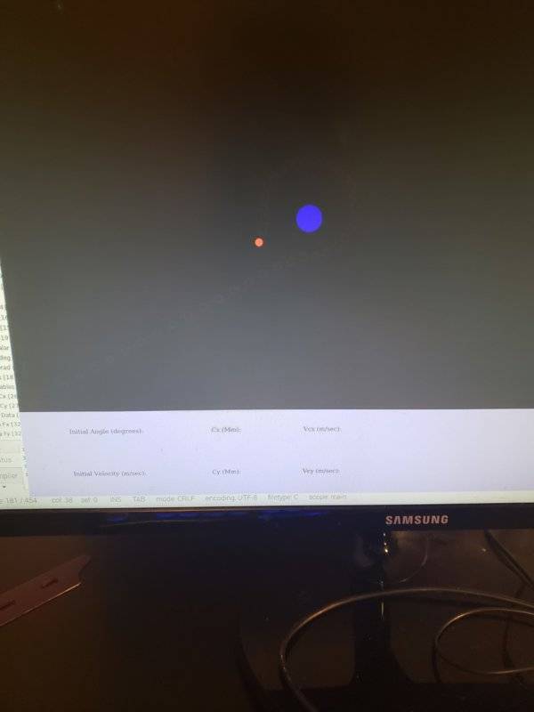

Hello and thanks for the reply. I think that early on in this project the idea of starting with a known angle and speed that would yield a stable orbit crossed my mind, but I quickly discarded the idea when I realized that I do not know how to calculate a stable orbit.
By setting Cy = 25e6 and Cx = 0, the asteroid starts just north of the Earth. Using your equation with r = 25e6, I find an initial speed for the x-component to be 3994 m/s.
Assuming that the angle is 0 here... I know that Vcx = Vc * cos(0) which means that Vcx = Vc. The initial speed input of my program uses the total magnitude of both the Vx and Vy components. In this case for an angle of 0, Vcy = Vc * sin(0) which equals 0. So the total magnitude is just Vcx in this case? I think that this makes sense but it has been a while since I have done anything like this.
In any event, if Cx = 0 and Cy = 25e6, and with an initial angle of 0 and an initial speed of 3994, the asteroid makes a perfect half circle from (0, 25e6) to (0, -25e6). Once the asteroid crosses back into Q3, it all falls apart and I lose my potentially stable orbit. I have included a picture of the output for your suggestion to this post (0-3994.png).
I have included another picture, called 30-8000.png, which shows the asteroid beginning from the bottom left of the screen as I initially had it. The asteroid passes from Q3 into Q4 into Q1 and into Q2, in what looks like a pretty healthy circle. Once it crosses back into Q3, I once again lose my potentially stable orbit.
What your suggestion and my initial attempt both have in common is that they both fall apart in Q3. I have not solved this problem yet, but I believe that the issue has to do with this bit of code:

Can you tell me more about the equations that you have posted? I have never seen them before. I will try to implement these suggestions.
When calculating the square of the distance between the asteroid and the Earth with R^2 = (Px - Cx)^2 + (Py - Cy)^2 does the size of Px and Cx matter? I don't think that it does because you end up squaring them anyway and forcing them positive. The same seems to be true for calculating the initial angle with B = arctan((Py - Cy)/(Px - Cx)), with the exception of the squares.
Can you explain why you need Px and Cx? It seems to me that only one is needed, ##x##, the x-component of the position vector from the force center (here the center of the Earth) and the asteroid. Likewise for ##y##. The formula suggested by @haruspex in #6 is based on this idea and that's the meaning of ##x## and ##y## therein. Note that these are algebraic quantities, meaning they can be positive or negative. In Q1 both are positive, in Q2 ##x<0## and ##y>0## and so on. Using ##x## and ##y## in this fashion takes care of the quadrant problem automatically without any if statements and also allows finding the angle by using the appropriate arctangent.
I was under the impression that I need Px and Cx, as well as Py and Cy, to calculate the distance between the asteroid and the Earth. The distance between the asteroid and the Earth are needed to calculate the force exerted on the asteroid by the Earth? And with this force, which changes with each iteration of the loop, I can update the acceleration components? Is this wrong?
What is k in the equation that haruspex mentioned?
It is what it says in my post. You can calculate it once at each iteration then use it in updating both x and y velocities.
You still have not explained what Cx, Px and Cy, Py stand for. The gravitational attraction force in Cartesian ##x## and ##y## coordinates is given by $$\vec F=-GM_Em\frac{x~\hat x+y~\hat y}{(x^2+y^2)^{3/2}}.$$Here ##x## and ##y## are, as mentioned earlier, the coordinates of the asteroid relative to the Earth which is assumed to be at the origin. The acceleration is obtained by dividing out the mass of the asteroid. Splitting it into Cartesian components,$$a_x= -GM_E\frac{x}{(x^2+y^2)^{3/2}};~~a_y= -GM_E\frac{y}{(x^2+y^2)^{3/2}}$$The ##k## as defined by @haruspex is the common factor ##\frac{GM_E}{(x^2+y^2)^{3/2}}## that appears in both ##a_x## and ##a_y##. Note that when the acceleration is expressed in this fashion, it is directed towards the force center and gets updated after ##x## and ##y## are updated.
With the asteroid at coordinates (x,y) relative to Earth as origin,
I.e., x=Cx-Px, y=Cy-Py:
The force of attraction is ##\frac{Gm_Em_A}{(x^2+y^2)}##
The acceleration has magnitude ##\frac{Gm_E}{(x^2+y^2)}##
To get the magnitude of the component of this in the x direction we multiply by ##\frac x{(x^2+y^2)^\frac 12}##. But we know the direction will be opposite to x, so we get the signed component as ##-\frac {xGm_E}{(x^2+y^2)^\frac 32}##
In the y direction, the same except y in the numerator instead of x, so it is convenient to calculate
##k=\frac{Gm_E}{(x^2+y^2)^\frac 32}##
##\dot x-=kx\Delta t##
##\dot y-=ky\Delta t##.
