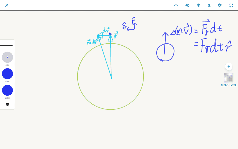

Why do say that ##\vec F_r\cdot d\vec r=0##? The two vectors (thrust and radial displacement) are non-zero and in the same direction. The same applies to ##m\vec v\cdot d\vec v##.
Hope this diagram can help you understand my reasoning. Here, ##\vec r## is the position vector of the spacecraft , and ##d\vec r\parallel \hat\theta##.

Hope this diagram can help you understand my reasoning. Here, ##\vec r## is the position vector of the spacecraft .
If the spacecraft receives an impulse ##\vec F dt=F_r dt~\hat r## in the radial direction, it will have an acceleration also in the radial, not tangential, direction whether it is moving or not. That's Newton's second law. Thus, the change in the position vector will have a radial as well as a tangential component, i.e. ##d\vec r=dr~\hat r+r d\theta~\hat \theta.##

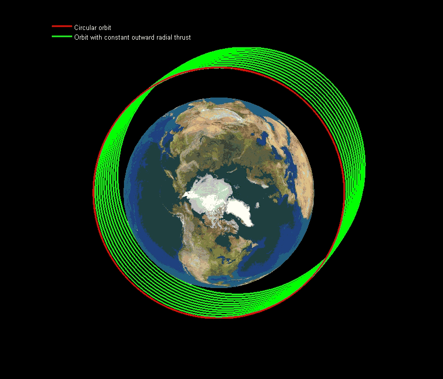

Okay. It appears that my description of the situation is completely wrong, according to the following post on PSE:
https://physics.stackexchange.com/questions/70357/change-of-orbit-with-radial-impulse#:~:text=The radial velocity of a,cannot be a circular one.
The author of the post, who is a space engineer, made the statement that: "This is because the radial force does not bring about any changes to the angular momentum. It does not increase the total energy of the orbit, just its in-plane offset." if there a constant radial impulse applied on the spaceship. So the change in orbit will look like the image below.
Since the energy is constant, the length of the two axes of the ellipse remain the same. The impulse merely moves orbit without changing its shape.
So I think the statement the author made is not true, and the descriptions of the orbit I made were also incorrect.
Case closed. Thanks.
Edit: Situation would be quite different when the impulse takes place in an instant. IMO the energy of the spacecraft might change because the magnitude of the velocity vector increases. The detailed explanation can be found in the answer the link directs to.
I doubt that that picture is correct. If I get a chance, I will attempt to to set up a simulation tomorrow.
If you with a circular orbit and apply a constant outward radial thrust (as described on that web page), what I would expect would be a roughly elliptical "orbit" with its "perigee" matching the original orbital altitude.
By "constant outward thrust", I mean a constant acceleration - so as fuel is burned, the force would decrease proportionally.
Are you sure? A short radial burn would result in an elliptic orbit with perigee below and apogee above the original circular orbit. Old and new orbit would intersect at the position of the burn. An elliptic orbit with perigee at original orbital altitude can be reached with a short tangential burn. Thus, I would expect that continuous radial thrust would be somwhere in the middle, continuously decreasing perigee.

  • #31
After sleeping on it, the "orbit" pictured makes more sense. In an orbit, the satellite travels more slowly on the apogee side than on the perigee side. So what would happen on each "orbit" with our rocket is that the radial thrust would average more and more towards the apogee - thus propelling itself to ever higher apogees.

A quick test simulation gives me the following. The radial thrust is 0.05 (yellow), 0.1 (blue), 0.13 (pink) of the gravity at the initial circular orbit (red). Note that none of the trusted orbits goes below the initial radius.
Likes Leo Liu, Halc and DrStupid
