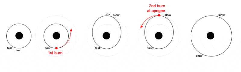

If you want to get from a circular orbit to another circular orbit with a bigger radius, you have to do some work against the gravitational potential energy field.
You have two basic choices about what to do first, accelerate or decelerate. One of them does positive work on the satellite, the other negative!
Also, you have to accelerate again when you reach the apogee of the elliptical orbit, to get the right speed to convert the ellipse into a circle.

Accelerating will put you in an elliptical orbit, with perigee at your original altitude and apogee at your new altitude.
But this elliptical orbit, even though it has more potential energy than your smaller, circular one, is slower at its apogee as it climbs. So, you've added energy, but you are going slower at the highest point.

No. The second burn is also an acceleration. This one you do at apogee.
The trick to changing orbits is when you do your burns.
