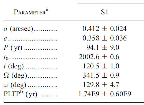

That's beautiful thanks tony873004. If I understand correctly, using the information below for the S1 star
we have that
[tex]
M_{0} = 360 - \frac{360}{T} (t_{0}-P)
[/tex]
using [itex]D=P[/itex]
which means
[tex]M_{0} \approx 360 - \frac{360}{94.1}(2002.6 - 2016.25)[/tex]
Does that sound reasonable?

Note that they give semi-major axis in milli arcseconds. This needs to be converted to a distance in order for the conversions from orbital elements to cartesian coordinates to make sense. We need to know the distance from the Earth to the black hole to make the conversion.
from the paper
...If not specified otherwise (§ 3.3), we adopt throughout this paper R0 = 8 kpc for the Galactic center distance...
...The updated estimate of distance to the Galactic center from the S2 orbit fit is R0 = 7.62 ± 0.32 kpc...
So therefore, looking at the semi-major axis for S1 = 0.412 arcsec and converting to meters gives:
8000 parsecs x 3.08568025E+16 meters / pc * sin(0.412 / 3600) = 493075008240113 meters
As a double-check, we can plug into the period formula (P =2pi sqrt(a^3/(GM)) and convert to years.
To do this, we need to know the mass of the black hole.
...The best-fit central mass9 for an assumed distance of 8 kpc is (4.06 ± 0.38) × 10^6 (solar masses)...
...The updated estimate of distance to the Galactic center from the S2 orbit fit is R0 = 7.62 ± 0.32 kpc, resulting in a central mass value of (3.61 ± 0.32) × 10^6 (solar masses)...
...Measurements of stellar velocities and (partial) orbits have established a compelling case that this dark mass concentration is a massive black hole of about (3[PLAIN]http://cdn.iopscience.com/icons/EJ4/AJ/ucp-icons/ndash.gif4) × 10^6 (solar masses)...
I think they made a typo in that middle sentence. I think they meant the distance from Earth, not S2. That would put S2 about as far away as Earth.
The period formula is P = 2pi * sqrt(a^3/(GM))
This gives seconds. Dividing by 3.155 x 10^7 gives years.
2*pi*sqrt((8000*3.08568025E+16*sin(.412/3600))^3 / (6.67e-11*3.61e6*1.99e30))/3.155e7
gives 99.6 years. Using 4 instead of 3.61 gives 94.6 years, which is in rough agreement with the period given for S1 in the data you quoted.

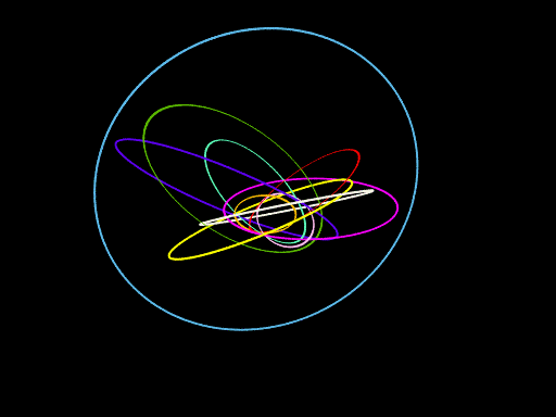

By gleaning data from a couple of the references listed in the OP and feeding them into the orbit simulator I have on my computer (Gravsim), I created the following Sim of a number of the stars orbiting Sagittarius A. Unfortunately, the Sim has no way to generate videos directly, so I had to resort to recording it from my monitor with a digital camera and saved the recording to youtube.(so excuse the poor quality)
It starts with the motions of the stars(highly sped up of course), and then finishes by tracing out the orbits.

That's pretty good for a camcorder aimed at a screen!
I'm surprised you didn't get a flickering strobe effect.
Unless you go full screen, the res is pretty good.
Did you use this one: http://www.grav-sim.com ?
You can download Camtasia to make screen recordings without the camcorder. It's about $200 but they let you use it for free for 30 days.
There's other free ones out there, but I never had much luck with them. I broke down and spent the $200.
