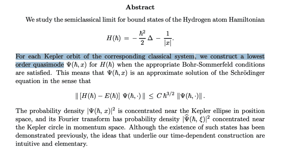

Ah, I see, this paper does a very similar thing,
https://pdfs.semanticscholar.org/3528/8dfad1167b34bdc50ecd694477fbbb9c52ba.pdf
