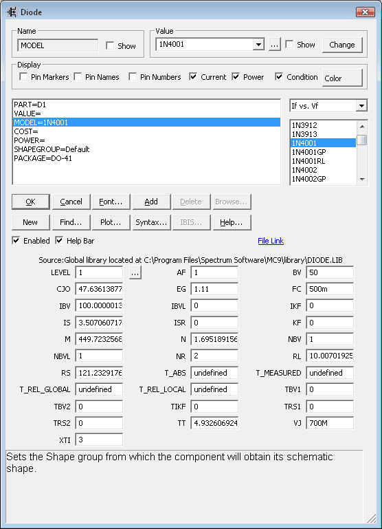

So my McroCAP SPICE simulator at work has lots of diode models built-in. Here is the model for the 1N4001 diode, in case it helps.
241915
