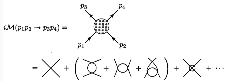

Then he calculates a 2-2 scattering process to the second order:
Here I have a few questions:
1. Why the fifth diagram in the second line of the second picture is of the same order to the previous three diagrams?
2. Now that [itex]\delta_m,\delta_Z,\delta_\lambda[/itex] are infinite numbers, how can they use perturbation theory and what is the meaning of order in renormalization perturbation theory?

Please explain why the one-loop diagram and counterterm diagram showed in my post is of order [itex]\hbar[/itex](especially the counterterm diagram). Most textbooks set [itex]\hbar=1[/itex] so I have difficulty finding this out.

I don't see any loops in the counterterm diagram(nor any ##\lambda## term), can you show me explicitly?
Take the example in posting #1. The three one-loop diagrams can be written as ##\mathrm{i} \mathcal{M}=-\mathrm{i} [A(s)+A(t) + A(u)]## with the usual Mandelstam variables ##s##, ##t##, and ##u##.
The one-loop piece ##\Gamma(s)## is logarithmically divergent. In dim. reg you have
##A(s)=-\frac{\lambda^2}{32 \pi \epsilon}+\text{finite}.##
In order to make this finite in the limit ##\epsilon=\frac{4-d}{2} \rightarrow 0##, you have to subtract at least this pole term (minimal subtraction scheme), and this is of order ##\lambda^2##, of course.
At the same time, the counterterm are always local terms as in the original expression. Thus in diagrammatic language it's usually drawn as some blob as in posting #1 (last graph). Technically these are the contractions of divergent diagrams in the forest formula.
If you go to higher order, you have to subtract first all subdivergences (which can be nested but not overlapping, which was the great achievement by BPHZ and is the essence of Zimmermann's forest formula). This is done by drawing all bare diagrams and contractions of divergent subdiagrams. The subdiagrams are of lower order and thus you know the counter terms and thus you know the Feynman rules for the contractions, which now stand for counter terms. These make all the subdivergences finite, and you are left with an overall divergence, which is again a local term as appearing in the original Lagrangian (that's the 2nd essence of the forest formula). In this way you can go inductively from one to the next loop (expansion parameter ##\hbar##) or coupling-constant order (expansion parameter ##\lambda##), which are equivalent for ##\phi^4## theory.
For details of the calculation, see p. 157 of my lecture notes. I just realize that I have to repair the diagram on p. 157. I hope, I can manage this right away!
